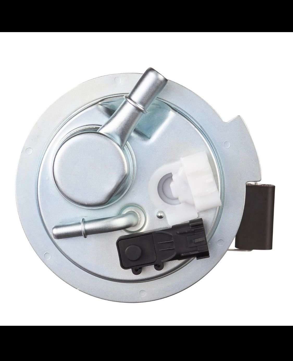

This is what I currently have installed
Old Apr 30, 2026 | 03:08 PM
Posts: 9,014

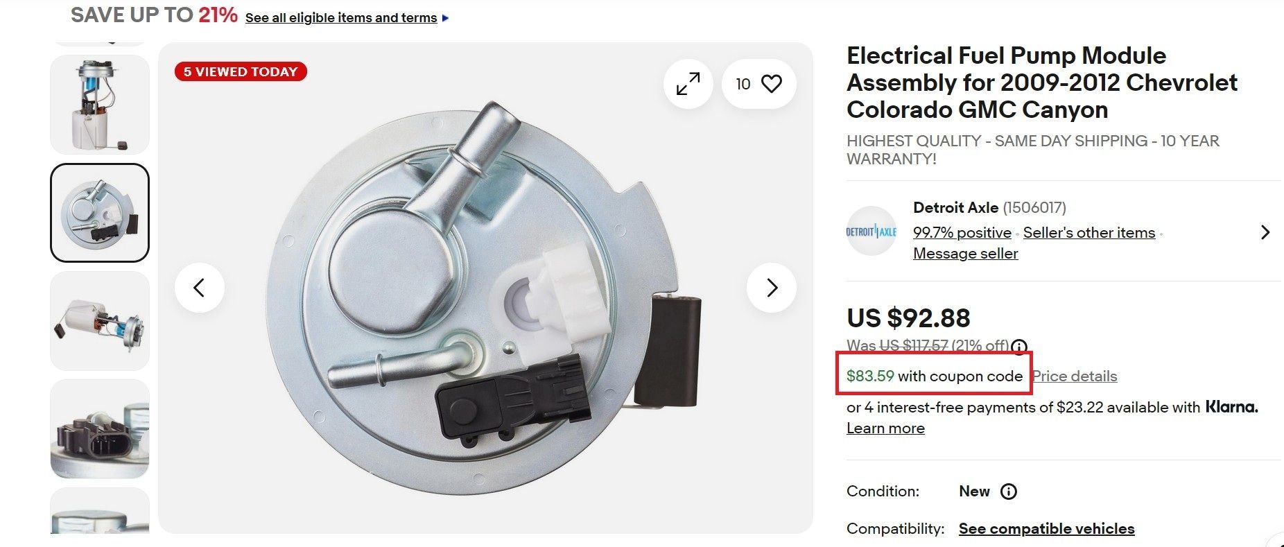

That appears to be a COLLY CANYON Pump=2009-2012 all models & engines.
Detroit axle has a sale on Da'bay right now for that pump
(10% off with code OVERLANDING10 Ends 07 May • Max $75.00)
'lot cheaper than a H3 FP...

Just weird why I have this one installed. Guess I’ll just order the proper line for the H3 pump
Old Apr 30, 2026 | 03:16 PM
Posts: 9,014
Somebody installed that aftermarket pump because the OEM 19206830 is DISCONTINUED.
Change the fuel line or get the COLLY/CANYON pump.
