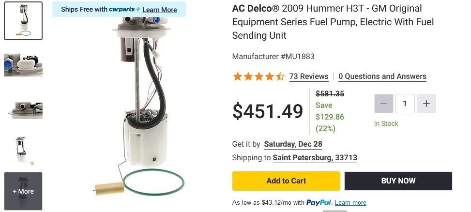

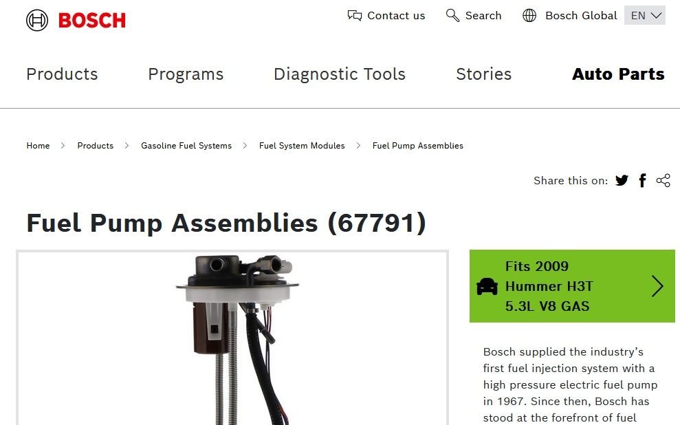

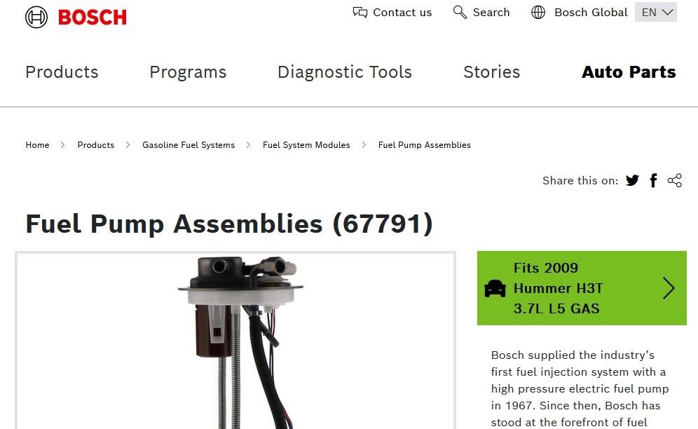

What's "completely wrong" with the bosch 67791?
2009 H3T fpm part numbers listed below:
MU1883, M10229, 67791, 69446, 19207847, 19207848 19208880, 19208881, 19370390, 19370392
Here's a fpm on da'Bay with free shipping 30day return(seller would most likely just issue a refund if it doesn't fit)
>>>>Fuel Pump Assembly for 2009 Hummer H3 & H3T 3.7L 5.3L GAM1310

Hey BP73, what's up?
Can you expand upon why the Bosch pump you bought was wrong? RockAuto has the Bosch pump for the H3T Alpha as well so I am wondering. RockAuto shows the MU1883 for the H3 Alpha and they have them in stock. I do not know if or what the difference would be in fuel pumps for the H3 Alpha vs H3T Alpha.

OK, thanks I’ll check this out. I’m pretty sure the pub that they sent me was for the five cylinder not the VA, which is why it wasn’t the same at all. However, it was listed as the V8, but it wasn’t. I’ll try those part numbers you’re talking about.
