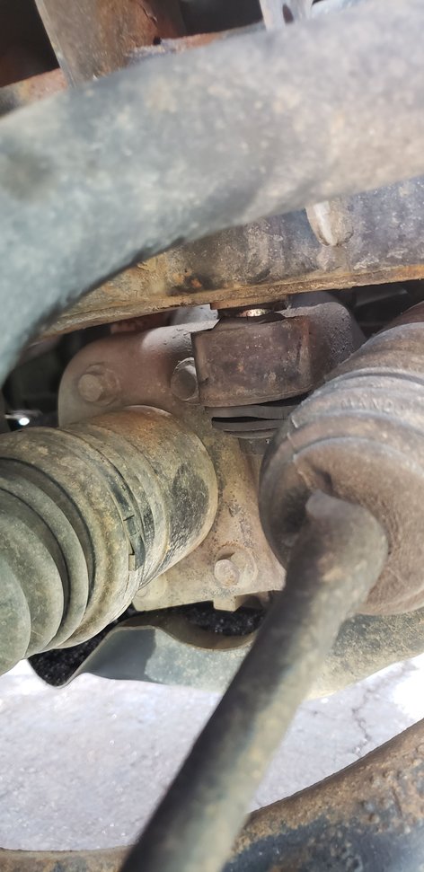

Anyone know this name of bushing
Old Aug 20, 2019 | 07:23 PM
Derrick Boyle's Avatar
Joined: Aug 2019
Default Anyone know this name of bushing
Looking for the name of this bushing? Looks shot.
Old Aug 20, 2019 | 07:52 PM
Posts: 3,207
hard to tell but might be a Front Differential Axle Support Bracket Frame Bushing
Old Aug 21, 2019 | 10:01 AM
You can either order the entire bracket (buy both sides, because the other one is probably just a bad or getting close) or you can order the kit from Outfitter Design which will replace the diff cross member bushing too.
15856422 Left
15856421 Right
or
H3 D.I.Y. FRONT DIFFERENTIAL BUSHING KIT
https://www.outfitterdesign.com/do-i...shing-kit.html
