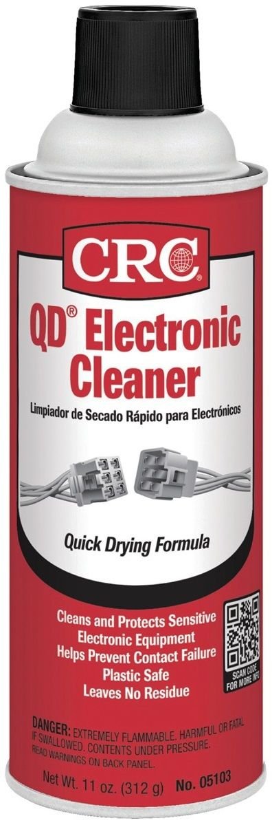

Clean the ignition switch and connector contacts, and clean the TR switch and connector contacts:
