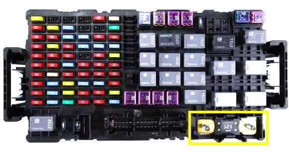

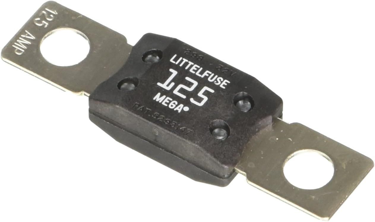

What does the MEGA FUSE look like?
Old Apr 3, 2025 | 06:40 PM
Posts: 9,015
Old Apr 3, 2025 | 07:02 PM
Posts: 9,015
Originally Posted by NMH3
Any idea what caused the fuse to fail? .
{{{{B+Short+<To>N-Ground-}}}}

HUMMERZ- Great pictures!
