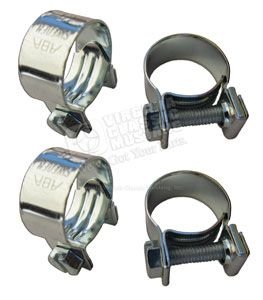

You were lucky to get what you did out of it before the hose demons reared their ugly head. Worm gear clamps suck for that application and the hose barbs on your cooler suck for that application. In marine applications, a long barb is always double clamped, each going the opposite direction. Upgrade your clamps to something designed for pressurized transmission hoses that have a full band.
Like these at a minimum.

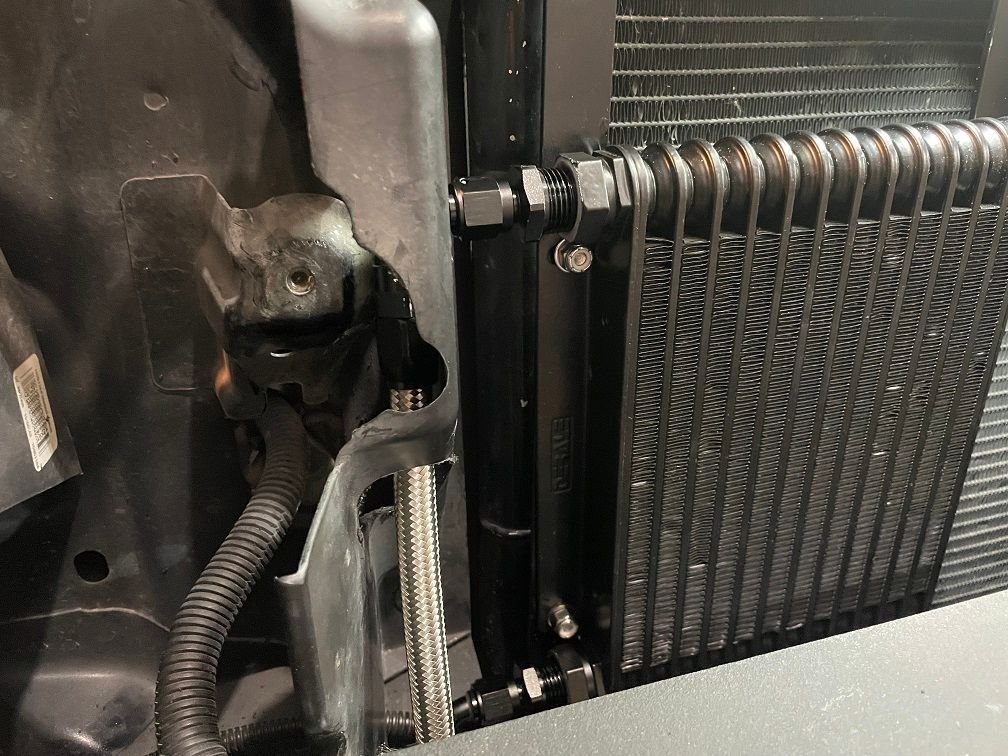

Replaced crappy cooler with remote cooler from Derale: Details here
On the trans lines close to the radiator I replaced the hose barb part on the hard line with a compression fitting to 6an. 6an hose to cooler with same connection. No more clamps and going strong. Thanks for all the help!
