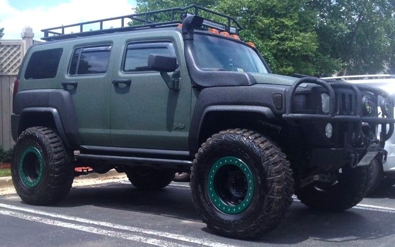

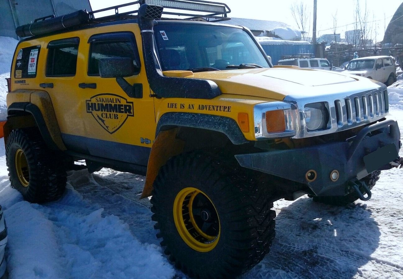

You're missing the concept! The snorkel brings in the coolest air(a.k.a.> cold air intake). As you know, sealed air box under the hood that reaches 190°-230°+, however, the oem air box inlet is in the wheel well with the brakes that reach 200° normally yet can hit 1000°+. With a snorkel you will ONLY get ambient air temperature=>BEST POSSIBLE C.A.I.

I wonder just how much difference in air temp from 3' above the road vs 6' above the road, and considering the wheel well liner, doubt seriously that the brakes are adding much heat inside the fender of a moving H3. I have also heard that the high intake of the snorkel reduces the amount of dirt/dust that is sucked in. Again, measurable, or off-roader wive's tale? Of course, the snorkel would also add restrictions to the air flow, so...Hmmmmm...

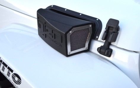

Restriction? The air intake scoop is mounted out in the open not inside the fender. A ram-air intake is any intake design which uses the dynamic air pressure created by vehicle motion, or ram pressure, to increase the static air pressure inside of the intake manifold on an internal combustion engine, thus allowing a greater mass air flow through the engine and hence increasing engine power. You could also mount a ram air scoop above the fender as shown on this cheep:

True that it is a ram effect while moving, but you've also introduced more than 270 degrees of angles and 3-4' worth of additional length to the intake tract, so....
Old Apr 30, 2024 | 09:27 AM
Every time a bend is introduced to an air path pipe restriction occurs. A single 90 degree long radius bend in the Alpha 3.5" intake is the equivalent of 6 feet of pipe, a tight radius 90 bend is the equivalent of 9 feet of pipe = sucking through a straw by analogy. Tighter the 90 degree bend, the lower the efficiency. The longer the pipe, the less efficient the intake.
Snorkel= 90 tight radius at the top, appx 90 degree long radius at the fender, tight double compound bends going through the fender and inner fender all before it enters the intake air filter box. Let's say the Snorkel is a total of 5 feet long, add in the bends, that is: 5 + 9 + 6 + 9 + 9 = 38 feet. That is a long straw to suck in air before it even gets to the filter. I can say from an intake perspective, a snorkel sucks. Pun intended.
The OEM intake draws its intake charge from inside the inner fender which is NOT heated by brakes 18" below in the open fender. In fact it gets its air from around and through the turn signal/far right grill (that is not sealed off).
Ram or no ram, shorter is better.
