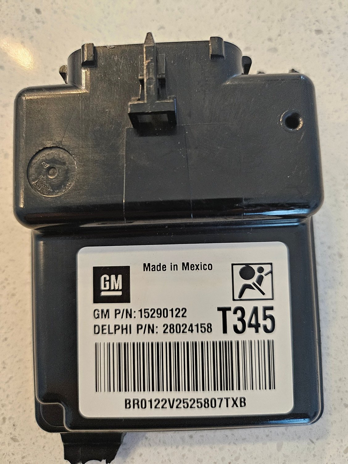

Just getting around to troubleshooting the airbag light which is constantly on. The code os a B0092. I found this module umder the passenger seat just hanging and not mounted. Does anyone know where exactly this mounts under the passenger side seat?

do not flip that around with it connected and in acc or run position. you will definitely have a bad day. it contains the air bag roll over sensor. disconnect the battery and wait at least 10 minutes so the emergency reserve power bleeds off.

This part number says it is the passenger side seat occupant module, nothing about a rollover sensor?

you can play russian roulet if you want too. i am just giving you sound advice

Thanks I appreciate that and I definitely won't mess with it especially with power going to it!

here it happens to a seasoned mechanic.

A bit of info on this code... from gm gmc but...
https://www.gmtruckclub.com/threads/...olved.1482030/

YEAR AND MODEL are always important!
Was it wired, or just left under the seat? Any chance the prior owner just disconnected it hoping codes would disappear?

Yes it was plugged in

And, still no Year and Model (yeah we know it is an H3, but which model H3: Base, Adventure, Lux, Lux off road and not an Alpha?).
