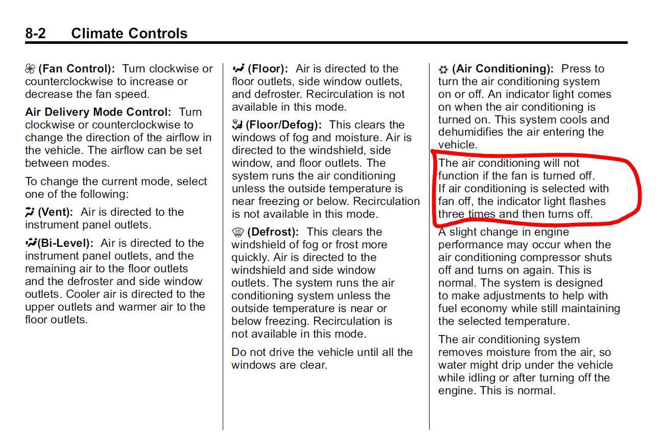

I just bought my first hummer and am so excited! I want to get all issues fixed as soon as possible. My ac doesn’t work but it is still fairly cold where I live, I just want to be ready for summer. I’ve read if the ac does the 3 lights blinking that means something is wrong. I took it to a shop and they replaced the climate control sensor I believe, but the three lights still blink only when I have the blower off. The shop told me they couldn’t add refrigerant because it is to cold out. Does the 3 blinking lights mean something is still wrong or is it just doing that because I don’t have the blower on? When the blower is on first it does not blink and stays on

There is absolutely nothing wrong with your H3 HVAC regarding the 3 flashes without the fan on. I suggest you go online to GM and download the Owners Manual for your particular year H3 and READ!
If your statement "I try to learn everything when and where I can about my cars…" was true you would have read the Owners Manual FIRST.

YES! Test/check vent temp/ac pressures in a heated garage! In order to properly charge automotive A/C system the ambient temperature should be above 65ºF. Anything below that does not allow the system to build up enough pressure for a proper reading on your pressure gauges.
