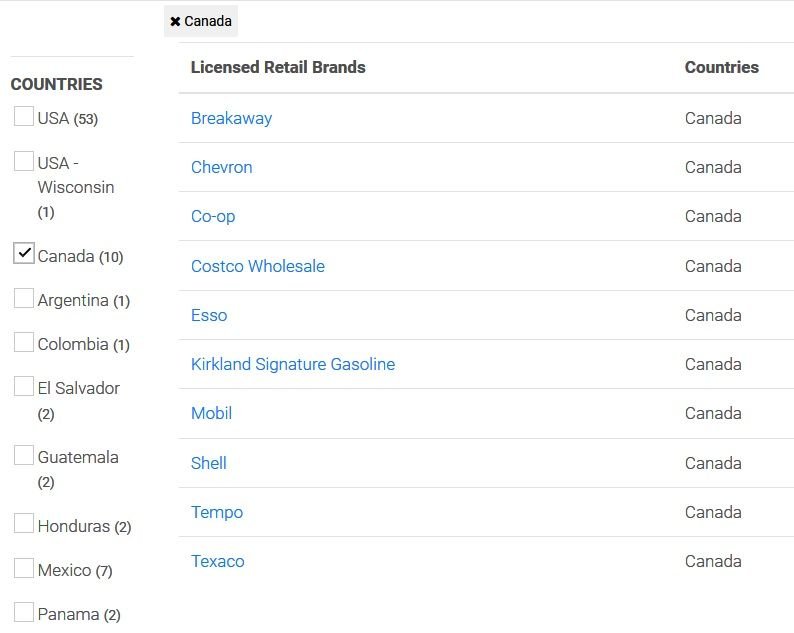

Old Dec 11, 2020 | 01:38 PM
UcraDen's Avatar
Joined: Oct 2019
Posts: 145
top tier? we dont have such in canada...
UcraDen's Avatar
Joined: Oct 2019
Posts: 145
btw, thanks for manual
Old Dec 11, 2020 | 01:42 PM
Posts: 9,014
Learn how to navigate websites.
Old Dec 11, 2020 | 02:26 PM
UcraDen's Avatar
Joined: Oct 2019
Posts: 145
Actually the Costco one its nice, and less expensive. Always trying to gas there..
