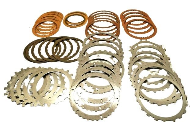

You have a couple years on me, however I've spent 40+yrs in automotive repair. Simple math for you: clutch plates wear, just like brake pads, if you don't use your brake pads, they don't wear, same with clutch plates.
3-4 is a common issue with the 4L60E:>4l60e transmission 3-4 clutch pack
https://youtu.be/leqR4iVAd5c
That is all very interesting, but... I see absolutely nothing there (or anywhere, for that matter) that suggests using only 3rd instead of OD will have ANY effect on tranny life (particularly not doubling it to 300,000mi).
What are you missing? I've had customers easily clear 300k+ driving with the 4l60e. Point being: shifts cause wear, more shifts>more wear. Drop your pan and check for clutch material.

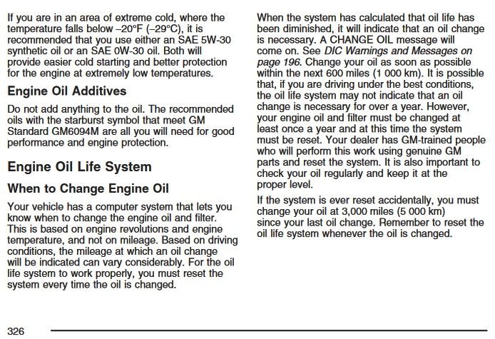

Except you are using information that is obsolete. Like people who change their oil every 3,000 miles, even though their GM vehicle is equipped with OLMS which tells you when to change the oil when it is needed, long after 3,000 miles.
Every time you move/drive, the AT is used, 1st & 2nd don't just wear out, but they get used the most every start & stop etc... Ride a bike if you want your AT to last forever.
Rely on the OLS? I've NEVER received a change oil message.
Instead, I change oil & filter when dirty and/or at least once a year!
2007 HUMMER H3 Owner Manual page 326:
It is possible that, if you are driving under the best conditions,
the oil life system may not indicate that an oil
change is necessary for over a year. However,
your engine oil and filter must be changed at
least once a year
