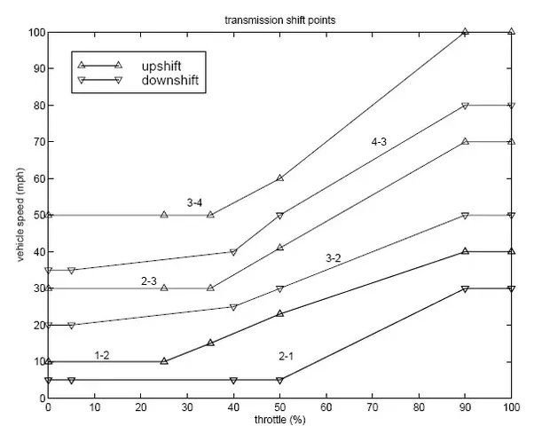

Old Jan 18, 2023 | 07:22 PM
I drive my 3 in [3] >>OEM 4l60e<< [D] only used 55+.
3-4/4-3 around 45(depends on throttle%):
[size=16px]
[/size]
Ok, Thanks. Seems like the 4L60E does a lot of 3-4-3-4-3-4 in the city which I would think would cause a lot of wear on a tranny. Will the engine take 2,500-2,800RPM around 50-55MPH without any noticeable engine wear or should I shift it into “D” when I’m above 2,500RPM.
