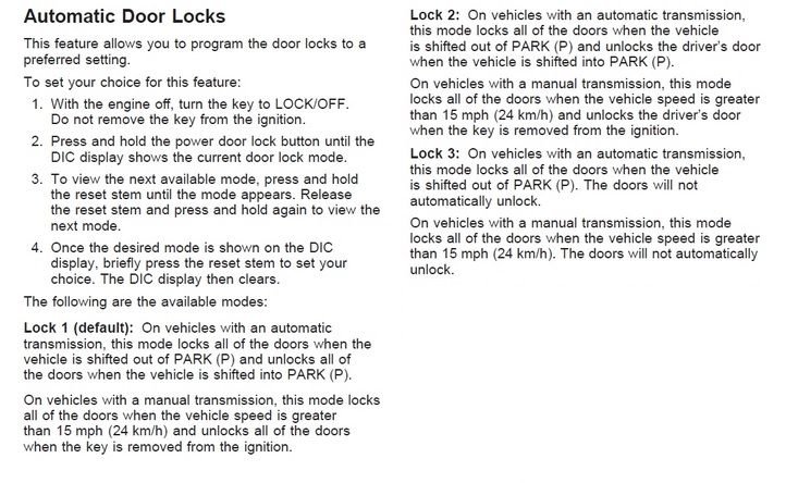

I love my H3, but it seems when I get one thing fixed, something else happens. So a few days ago my 2006 H3 stopped unlocking the passenger side and both back doors when I put her in park. I checked the door lock program and it's set to Lock 1 which should unlock all doors. Everything else works fine. The door panel control was recently replaced and is about a month old. I tried disconnecting the negative battery cable to reset the BCM thinking it may help, but nope. Does anyone have any suggestions to get this working again? It's not a huge issue since I can still manually unlock the doors, but I like things to work the way they are intended. Thanks!
Old Apr 18, 2021 | 01:51 PM
Posts: 9,042
That would be Lock 2. Try setting the different modes and check feedback:

I cycled through all 3 back to Lock 1 and it's still doing it.

10 second test between modes, to check bcm response. Btw, do you still get the 5x chime?

Got to check the lock programming this morning before work. Lock 2 and Lock 3 are working correctly. Lock 1 is still acting like Lock 2 and doesn't unlock the passemger/back door when shifted into park. I'll put the old control switch back in after work to see if that changes anything.
