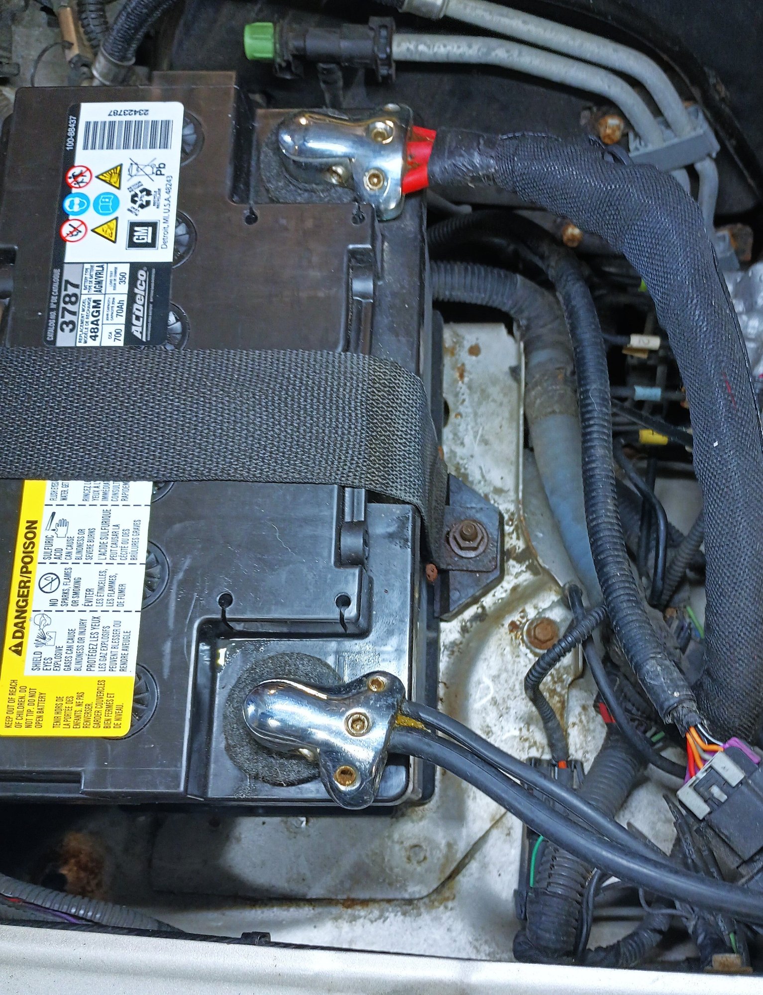

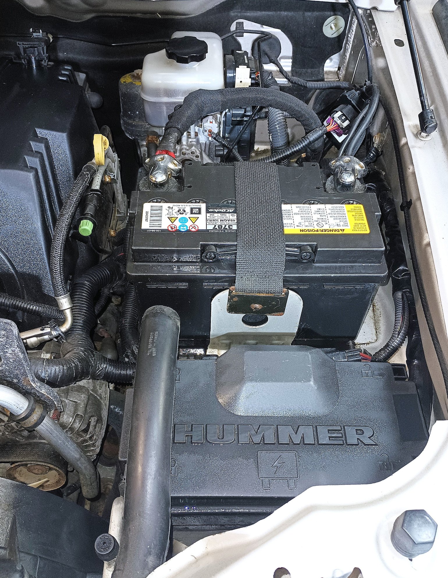

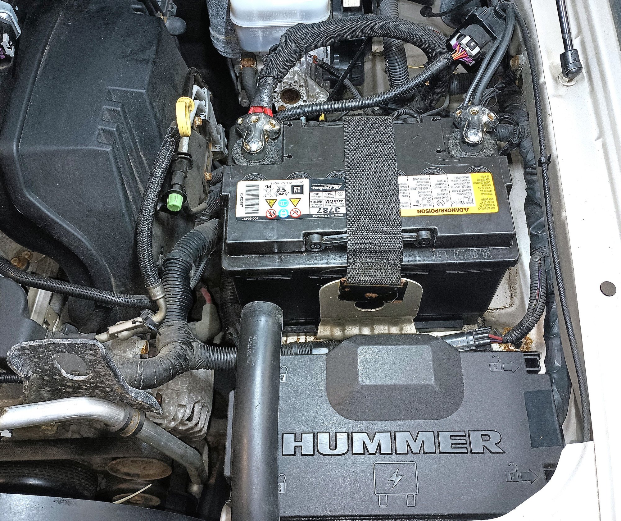

I had my GMC dealer replace the battery in my wife's 2020 at no charge with my gm rewards & received the old battery since it still tests good.
It's a group 48agm battery 2" longer(11") than the H3 group 86(9") battery with the same width to fit into the wedge mount hold down.
After removing the old battery, the lower plastic battery cover pulls out after removing 2 wiring harness connector clips attached.
Underneath the plastic cover the steel tray has an extra 2" length for an 11" long battery to set on. Then install the strap & wedge hold down to hold the battery secured in place.

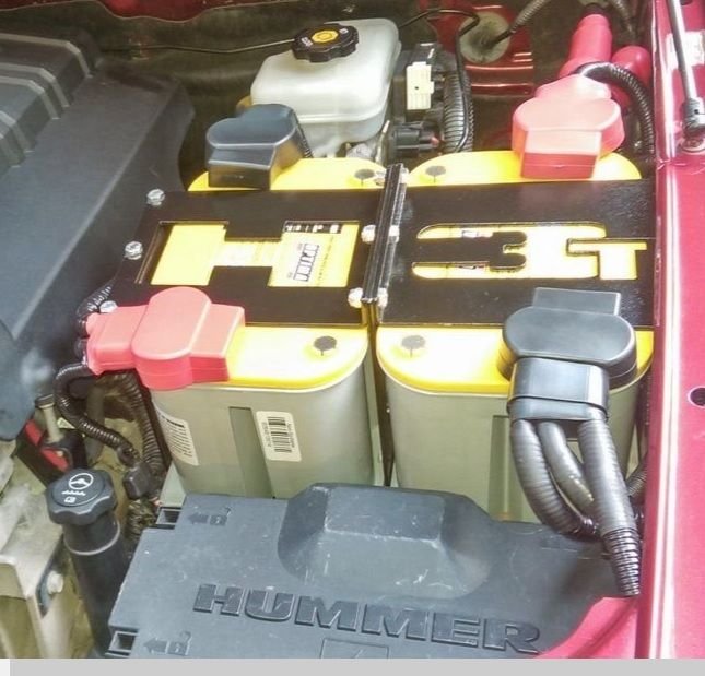

Anything will fit if you remove the darn batter tray! Why is this news?
I have 2 huge Optima Yellow Tops in the same location.

Fits without modification is the reason for the post.
6-7/8" width fits secured in between the wedge hold down bracket mount. 11" length fits inside the metal edging border. Larger would require modification.

I'm thinking it looks just like this.....................

The tray is big enough to take much larger than the stock battery.
The stock battery is rinky dink and "bigger is better"...

That's my "T", Thanks Doc!
reran all of the OEM wires after separating them from the OEM loom. re-loomed and heat shrank all the hydraulically crimped connectors.
Fuse cover still come off easily.

YOU MODDED WITH PLASTIC BASE PLATES TO HOLD THOSE BATTERIES SECURED ON THE METAL EDGING BORDER FRAME BELOW!
BTW, OPTIMA BATTERIES R UNABLE TO HANDLE EXTREME TEMPS!
