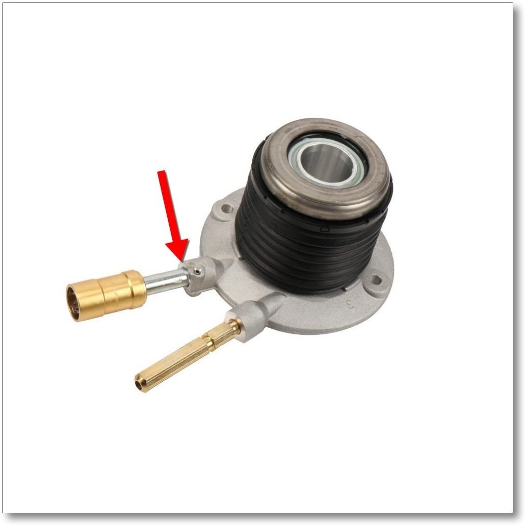

Good evening everyone,
2009 H3 Adventure with 133,000 on the odometer, 5 Sp manual transmission, and a puddle of what feels like DOT 3 hydraulic fluid directly below the weep hole in the bell housing. Upon partial disassembly and inspection, the quick connect receptacle on the clutch actuator cylinder (below) feels loose and can be moved around, almost as though it was unthreaded from the housing.
It would appear that this fitting is held in place by a roll pin, but I thought I would check here to see if anyone knows if there is a threaded connection to the housing, or if it is in fact retained by the roll pin.

Thanks @hummerz ... as usual you seem to be able to find just about anything. Disconnecting the line from the master was not the issue however. Here are the issues and some of the diagnostic steps I took to narrow down the problem:
  1. There is hydraulic fluid leaking from the weep hole at the bottom of the bell housing.
  2. The clutch pedal goes to the floor without disengaging the clutch, and it is no longer possible to put the vehicle in any gear.
  3. With the line from the master disconnected from the clutch actuator cylinder, the pedal has zero travel, so the seals in the master are not the culprit.
  4. Bleeding the system at the clutch actuator cylinder restores some clutch function, but within an hour, it is not functional.
  5. When the hydraulic line is removed from the input fitting receptacle on the clutch actuator cylinder, the receptacle itself can be moved around quite a bit with very little effort, almost as though it had unthreaded from the actuator cylinder housing, if that is how it was fastened. Looking at the image of the OEM part (below) there is a roll pin visible (circled) so I am unclear on whether or not the connection between the receptacle and the housing is threaded or something else.
I am just trying to find out if that fitting can be threaded back into the actuator cylinder housing to stop the leak. I hand turned it yesterday for a minute or so without any change in either the rate of the leak, or any sensation that the threads were bottoming out.

Looks like a spring (aka:roll) pin.
Arghhhhh... that's what I thought.
Thank's for the clarification sir... as usual, much appreciated!
