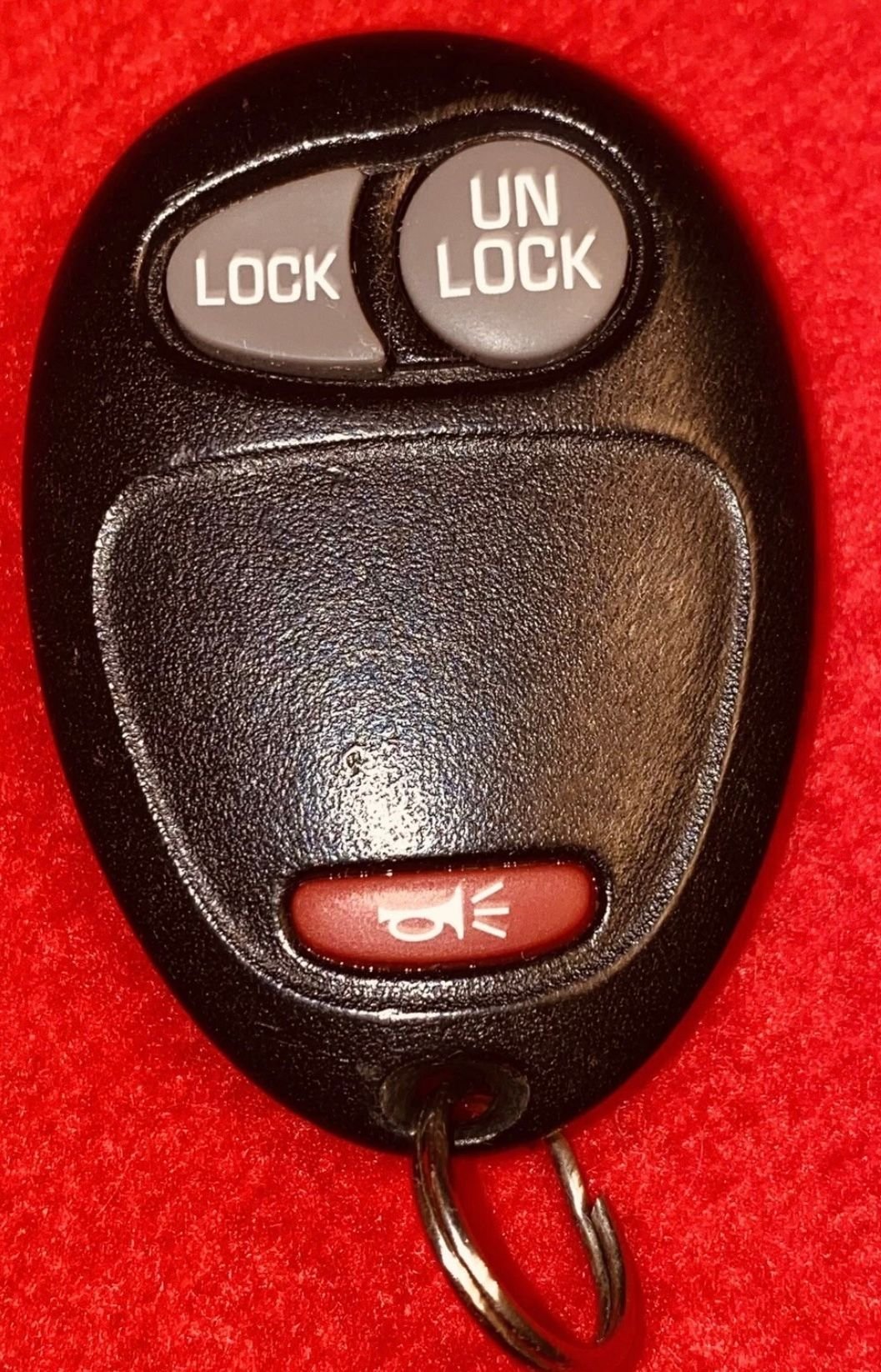

is your keyless entry remote the standard H3 design?
Old Sep 7, 2025 | 06:34 PM
gaber6's Avatar
Joined: Sep 2025
Posts: 44
Sorta standard, but with a trunk button. I tried a new battery in the remote today, too. I'll wiggle under and see where that little box connects and see if that resolves the issue. I have had the H3 for 4 months and this just started a few days ago.
