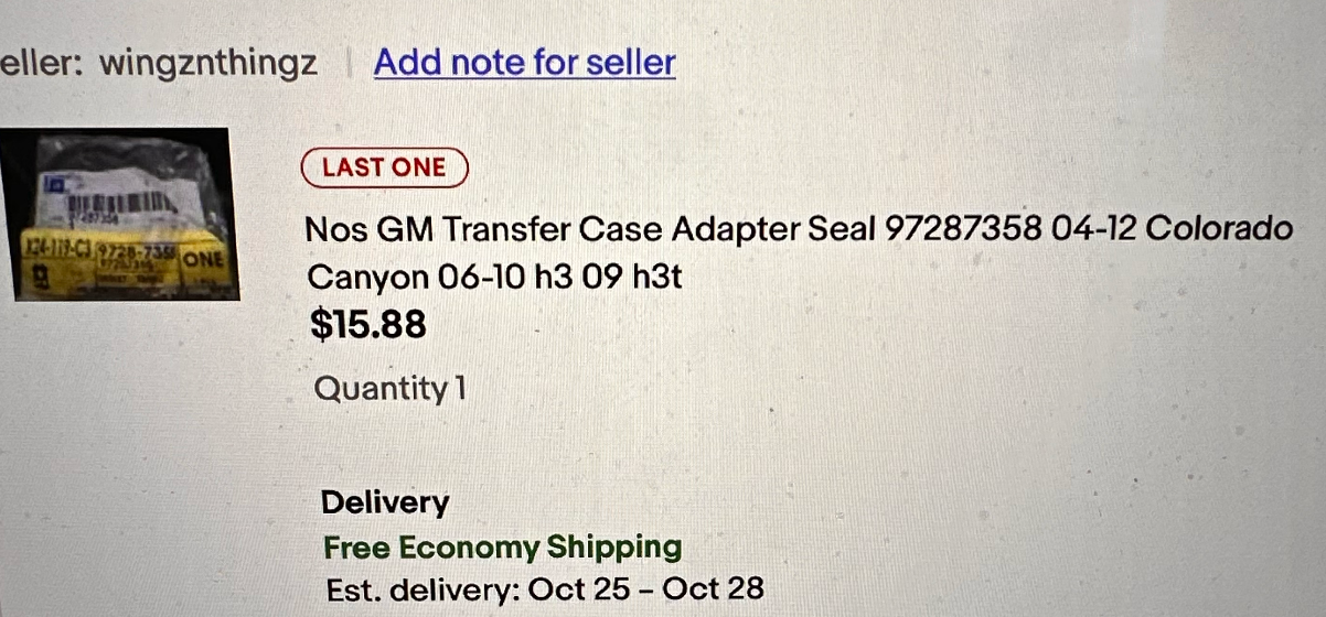

my mechanic was in there once already and said he replaced "a seal" but it was not the right one. said that I needed the output shaft seal. he didn't charge me for the first job because it didn't work. I live in a very small town where you don't have a lot of choices for mechanics. I suspect he is trying his best...

it was this part that I needed, and for whatever reason, its not easily available from regular stores. I ordered from eBay

For future reference
97287358 GM PN = Transfer Case Adapter Seal by National PN 710770 ($5.55 on RockAuto as of today)
Available at every major auto parts retailer in the US.
