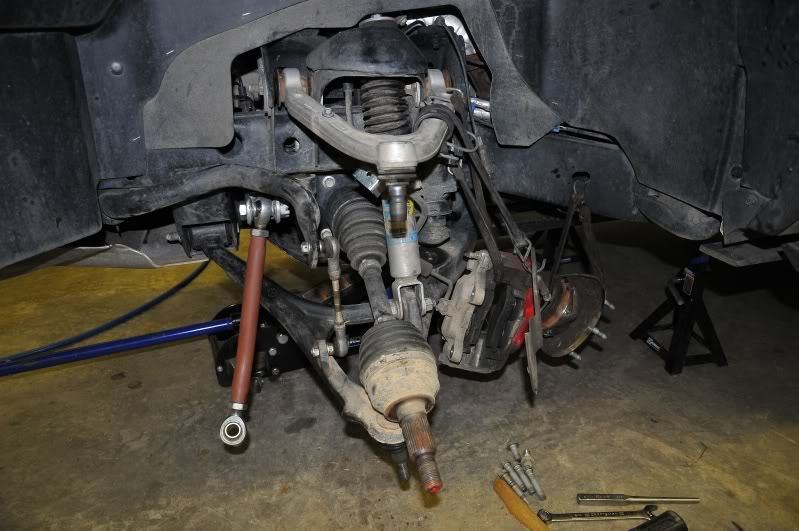

Depends on what you consider simple. Once you get down to this you can pull the shaft and replace the seal. Putting the shaft back in requires some care to not damage your new seal.

That looks easier than worrying about what someone else is doing to it when they are working on it lol. Thanks, the pic definitely helps me understand the time frame I'm looking at.
