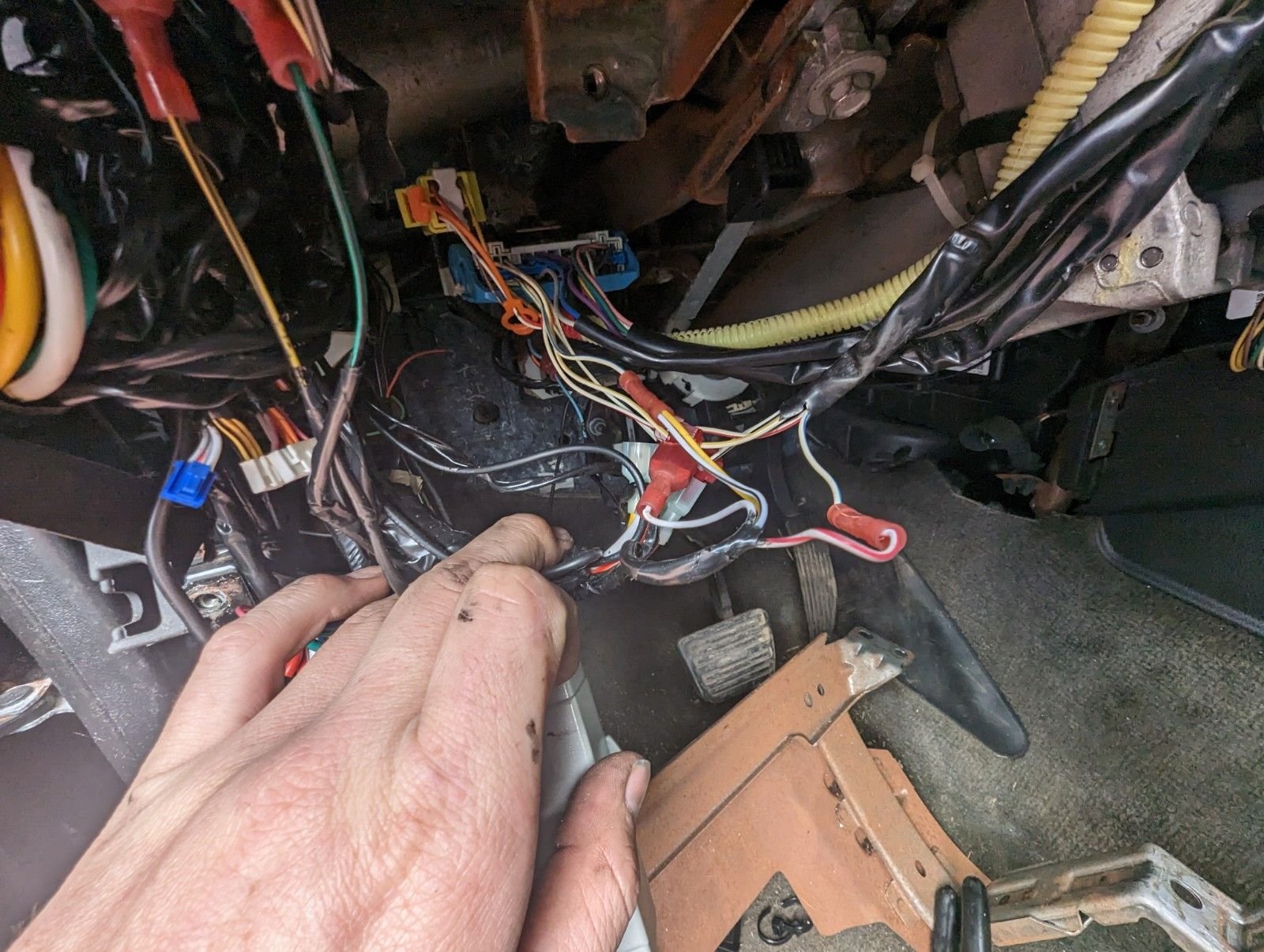

I am going to get some pictures and a vid of the truck I dont see any bad pins.

OK so tore apart the whole dash and this is what I found I want to go back 100% stock I think the small black box is auto starter but any idea what this big white box is??? There is **** wired in all over to rule it all out I plan to cut it all out and return it back to OEM I just dont know what the white box is.

Posts: 30
Ok I just found the white box on ebay turn out to be a really old auto starter. The Second black box is also a auto starter just newer why the hell there is 2 installed on top of eachother blows my mind a bit.....
GPS Tracking Devices Hidden on Financed Vehicles.

Ok thanks lot of good info in that But think with my ignition codes im just going to rip everything out including the badly installed radio If i ever get it to run il have someone install a remote start the right way i guess.
