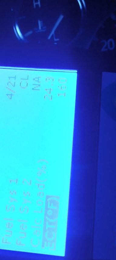

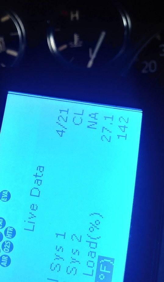

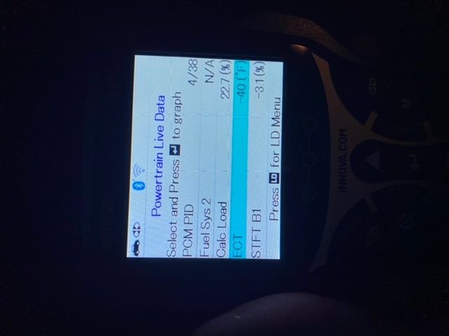

Do you have a scanner with live data that shows ect?
Old Mar 1, 2020 | 05:14 PM
Usmcvet's Avatar
Joined: Mar 2020
Posts: 6
Iam currently about to pick one up. I’ll write back with the info later tonight.
Old Mar 1, 2020 | 05:25 PM
Posts: 9,017
I just checked mine at startup, the gauge starts to move @ 140°
@160°
Old Mar 1, 2020 | 05:47 PM
Usmcvet's Avatar
Joined: Mar 2020
Posts: 6
