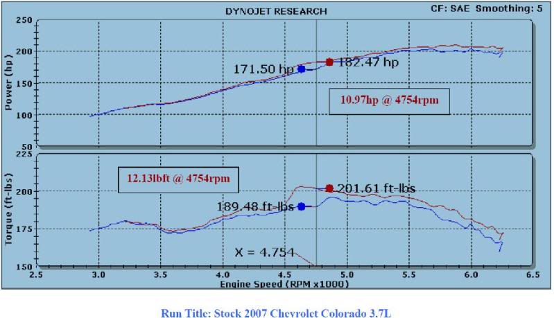

You "buddy" at FSR is daft. The I5s have a robust response to intakes, if he ever actually worked on one he might have a clue. Maybe you should re-read post #2 and consider yourself corrected. Here's a tidbit for your buddy, 10HP from nothin but an intake.
I've pulled 202 with my 07 on 33s at 40PSI, but it has a bunch more than just an intake. Considering a bone stock 3.7L H3 pulls about 173-175, I'd say picking up 100% reliable 25HP & TQ ain't bad.
As to H3 I5 exhaust, by itself, does virtually nothing except provide some sound. You can make some HP with a gutted Mini-Cat or with a header, but that's a different story. A better flowing exhaust works well with other mods, but the proven biggest bang for the buck is a PCM Tune and an intake, followed closely by an Efan conversion.
At a quick glance, your 10 hp gain seems to be simply a very short-lived blip on the overall curve. At 4500 rpm and 4850 rpm, the hp gain appears to be next to nothing.
Now the torque curve is increased throughout and looks to be a much more even and noticable gain, especially at normal rpm range encounter in everyday driving. It's also the one that you actually feel in the 'seat of the pants'.
That's the one you should be using as an example of perfomance benefits of adding an intake.
