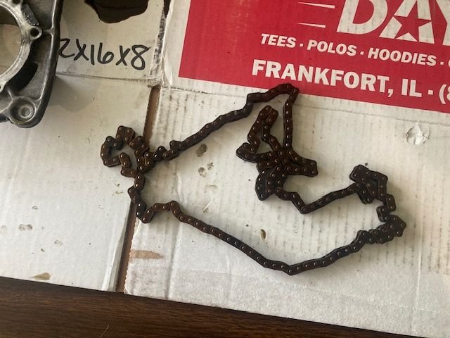

Old Timing Chain
Old Timing Chain

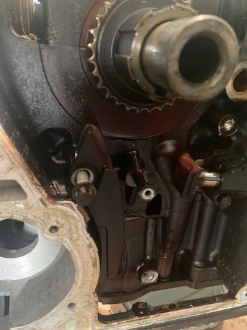

Front Timing Area
Front Timing Area
Timing Chain Tensioner Bolts - I used a breaker bar.  They were pretty tight, enough that an impact driver couldnt loosen them.
Timing Chain Tensioner Bolts - I used a breaker bar. They were pretty tight, enough that an impact driver couldn't loosen them.
Front Timing Chain Tensioner; very little tension on this little guy!

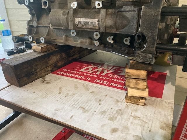

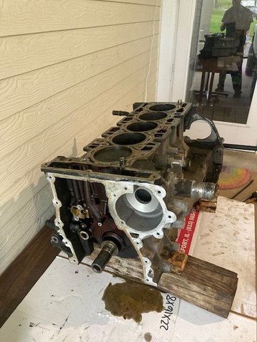

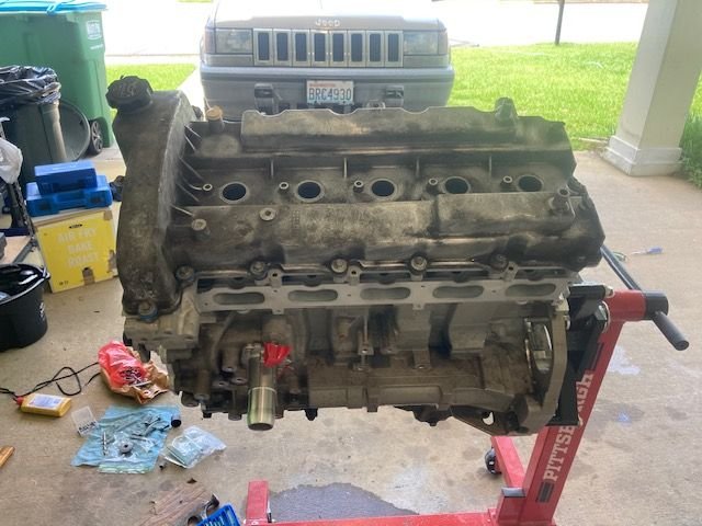

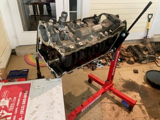

Rotating the engine in order to set it on a work bench.
Engine on work bench; wood underneath ensures the weight of the block is not applying pressure on the crankshaft.

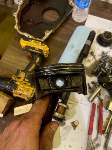

Rear Cover Removal; oh the trouble begins.....
Pry the cover off here.
Gross.
Gross.

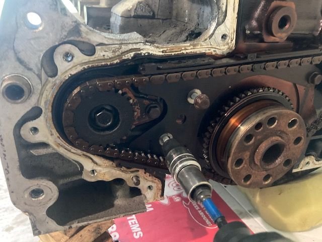

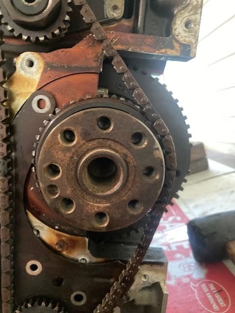

Removal of the balance shaft chain tensioner.

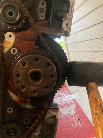

With the bearing brace/caps not installed (a mistake on my end), there is still too much tension on this chain.  Take one hand (not shown due to working the camera) and try to pull the chain off the crankshaft.....
.....then take a rubber mallet and give the crankshaft a few whacks while you are trying to pull the chain off the crankshaft gear. After a few whacks, I was able to break it loose. All of this can be avoided by waiting to remove the bearing brace/caps until AFTER this balance shaft chain is removed.
Pry HERE...
Pry HERE...
Not here (on this broken piece).

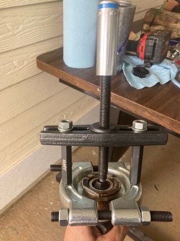

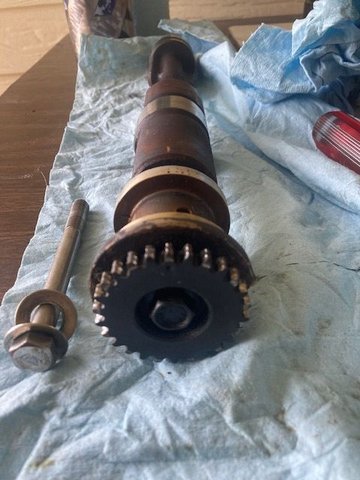

To remove this.....bearing thingy?, first use an allen key to hold it into place.
To remove this.....bearing thingy?, first use an allen key to hold it into place. Then grip it with channel locks, and loosen the bolt.
Note to all: this is a RIGHTY-LOOSEY bolt.
Bearing puller to remove the broken piece.
Balance shaft gear/bearing thing removed.
Notch in the shaft to keep it in time with the gear.
Another view.
Another view.
Balance Shaft Gear removed
Another notch in the gear; this means the gear can only be installed onto the shaft one way (a good thing)

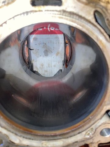

Cylinder Scoring :-( - and yet I thought I would be able to re-use these.
More Scoring.
More Scoring.
.....and more.
.....and more.

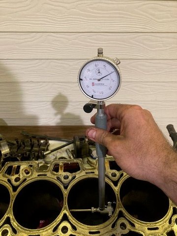

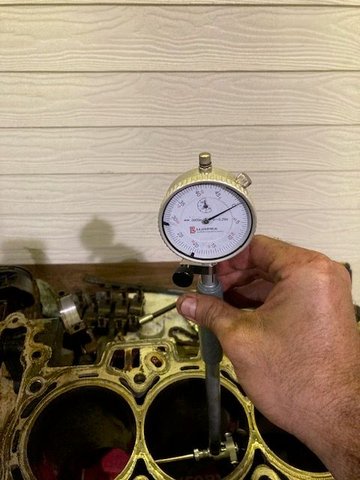

Dial Bore Gauge on the cylinders;  If not for the scoring, these likely would have been reusable.

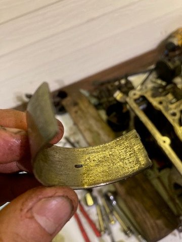

Not too terrible....??
Not too terrible....??.....not great, but not terrible.
.....yeah that's bad. Actual pitting on the main bearing. LAST picture for Part #2

Here is a great video online (relatively short) that shows you the basics of using a dial-bore gauge.

Balance Shaft Bearings Update - I was unable to remove these with a universal camshaft bearing removal/installation tool. My thought was I would be able to insert the tool into the balance shaft bearing, tighten the rubber piece on the universal tool to apply pressure, then remove them by attaching a slide hammer to the camshaft tool. Unfortunately this method did not work, and I was unable to get creative enough to find other (safe) ways to remove the bearings. I ended up ordering the Balance Shaft Bearing specialty tool from Ebay for nearly $700, however the seller (despite advertising a "complete set") did not send me several crucial parts of the tool to complete the task. I am now trying to work with them to send me the remainder of the tools, however bottom line, I did not remove/replace the balance shaft bearings. Upon inspection of the old bearings that were still in the engine block, they (surprisingly) were still in rather good shape, and the balance shafts both rotated freely when installed. While this may have been a hasty decision (not wanting to wait for the correct tool), I decided to just re-use the bearings that were still in the engine block.

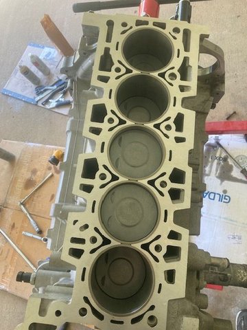

Now for the Good Stuff - Finally, with new cylinder sleeves, a new crankshaft, a rebuilt cylinder head, and a nice clean engine block, I could finally start reassembling everything. I'll let the pictures do most of the talking.
Fresh Engine Block
Fresh Engine Block

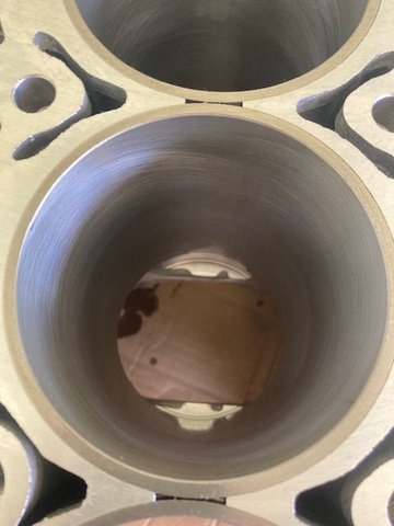

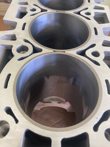

Cylinder Honing
Cylinder Honing
Cylinder Honing (2)
Cylinder Honing (2)

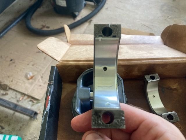

New Main Bearings
New Main Bearings

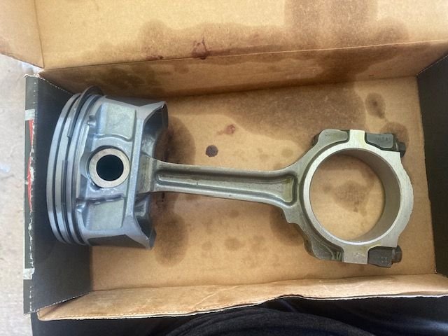

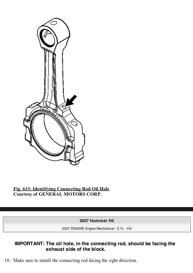

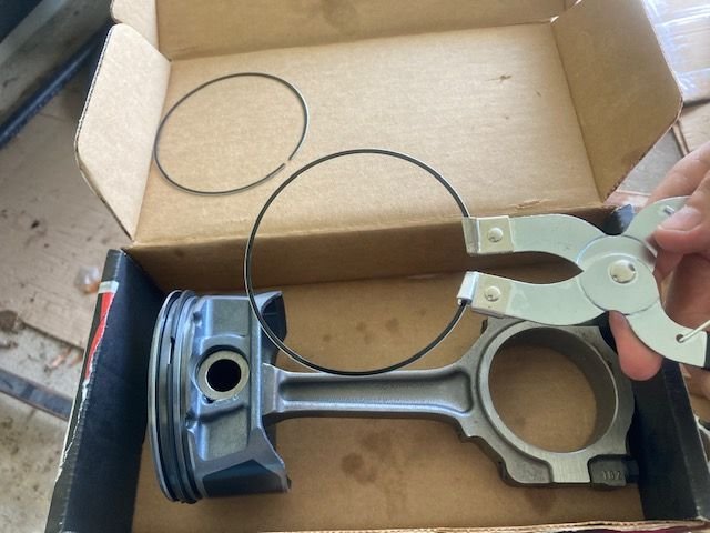

Piston & Connecting Rod - The 2x small snap rings that hold the piston pin in place was a PITA to assemble without a specialty tool, but I got there eventually. I did not capture it on camera, however on the connecting rods, there is a small oil control hole that should be facing towards the exhaust side of the engine. MAKE SURE you have this oriented properly. Reference the Schwartz service manual for the 3.7L engine for more information.

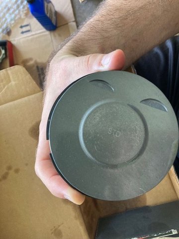

New piston; ensure the valve grooves are on the Exhaust Side of the engine.  I re-emphasize, the small oil control hole on the connecting rods should be facing the exhaust side of the engine as well.
Did I mention the small oil control hole should be facing the exhaust side of the engine?
Installing the piston rings using a ring installer tool.  If you order the kit from Mizumo Auto, they clearly label the upper/middle/lower rings which makes it a breeze to install these.  Be sure to reference the Schwartz Service Manual for the 3.7L engine as well.  Place the rings all 90 degrees off from one another.  The ring material is steel nitrated.
Installing the piston rings using a ring installer tool. If you order the kit from Mizumo Auto, they clearly label the upper/middle/lower rings which makes it a breeze to install these. Be sure to reference the Schwartz Service Manual for the 3.7L engine as well. The bottom oil control ring (which is two small rings, and a "separator" in the middle) did become slightly problematic, as they are all incredibly flimsy and did not want to seat properly and could get tangled up with one another if not careful. Be extremely delicate with the bottom rings, and do not "force" them into place. Once you have "all" of the piston rings installed, place the rings all 90 degrees off from one another. The ring material with the Mizumo Auto kit is Steel Nitrated.
Ensure the connecting rod bearing lines up with the small oil control hole.
The connecting rods are the Engine Tech brand.

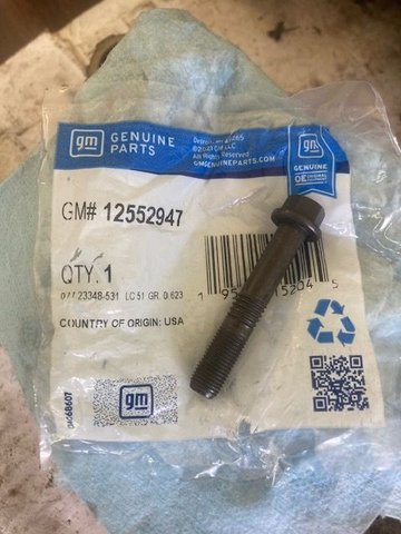

The bolts that came with the Engine Tech connecting rods were VERY tight and required a lot of force to loosen.  Since these are torque to yield bolts, I did not trust re-using them, so I ordered GM Genuine connecting rod bolts.
The bolts that came with the Engine Tech connecting rods were VERY tight and required a lot of force to loosen. Since these are torque to yield bolts, I did not trust re-using them, so I ordered 10x GM Genuine connecting rod bolts.
Installing new bolts.  The connecting rod bolts are first tightened to to 18 ft-lb, then an additional 110 degrees.  Do not reuse connecting rod bolts.
Installing new bolts. The connecting rod bolts are first tightened to to 18 ft-lb, then an additional 110 degrees. Do not reuse old connecting rod bolts.

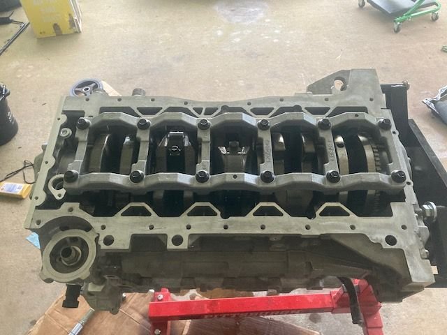

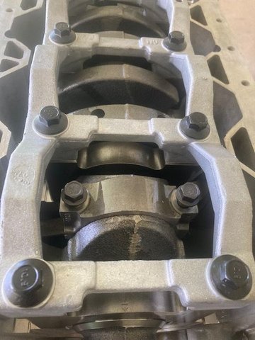

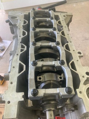

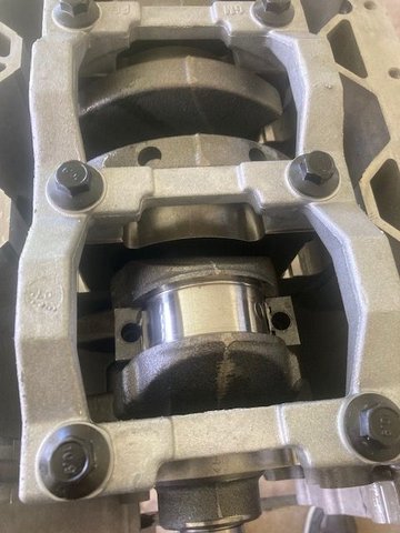

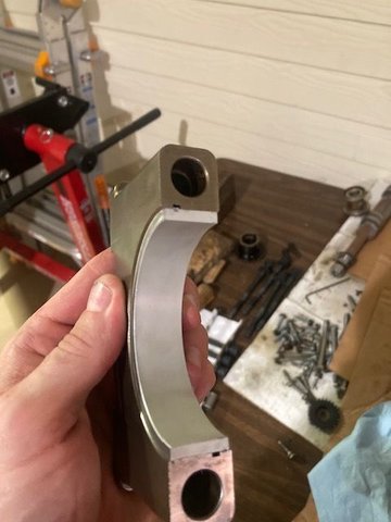

Bottom end completed.  The Main Bearing Brace Bolts are tightened to 18 ft-lbs followed by an additional 180 degrees.  Reference the Schwartz Service Manual for the correct order (also shown in the next picture).
Bottom end completed. The Main Bearing Brace Bolts are tightened to 18 ft-lbs followed by an additional 180 degrees. Reference the Schwartz Service Manual for the correct order in which to tighten these (shown in the next picture).
Piston Direction - Valve Grooves face exhaust side.

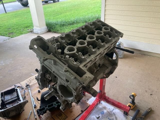

Cylinder Head Added to top of engine (not shown in photos is adding the head gasket).

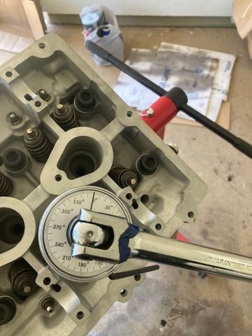

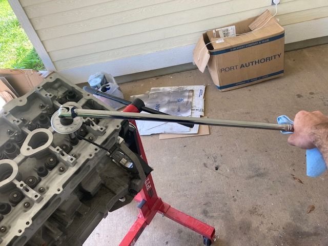

Tighten the cylinder head bolts using an angular gauge.  They should be tightened to
Tighten the cylinder head bolts using an angular gauge. They should be tightened to 22 ft-lbs followed by 155 degrees. These suckers get TIGHT!
Cylinder Head Tightening Diagram
Ensure you have the angular gauge zero'd out every time you tighten a cylinder head bolt
I knew I was on the right track when (after tightening all the cylinder head bolts), I ran a compression leakdown test in every cylinder and saw this! This was actually the "worst" cylinder, which showed barely about 10% leakage, and this is with the piston rings not even fully broken in yet! Much better than the 60% (40% leakage) I was getting in the previous engine!

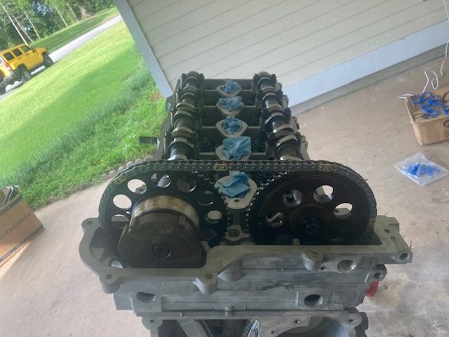

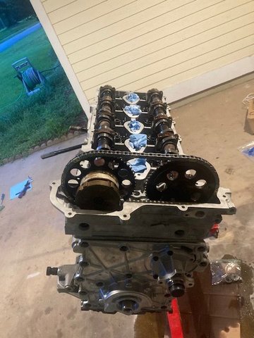

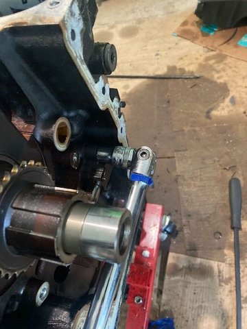

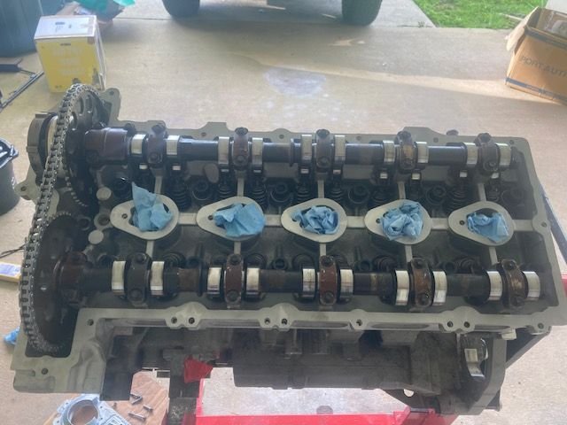

Camshafts & Timing Chain installed. When installing the camshaft bearing cap bolts, tighten them to 106 in-lbs or about 9 ft-lbs. I rounded up to 10 ft-lbs and (so far) there have been no issues. Make sure you install the caps in the same order & direction that they were in before you removed them (taking pictures really helps).
Another view of the camshafts. For the Intake Camshaft Sprocket Bolt, tighten first to 15 ft-lbs, followed by an additional 100 degrees. For the Exhaust Camshaft Actuator Bolt, tighten to 18 ft-lbs, followed by 135 degrees. I re-used both bolts (could not find new bolts online), and applied some blue thread-locker to both bolts. So far, after about ~1000 miles of driving, they have held up just fine.
Timing Chain

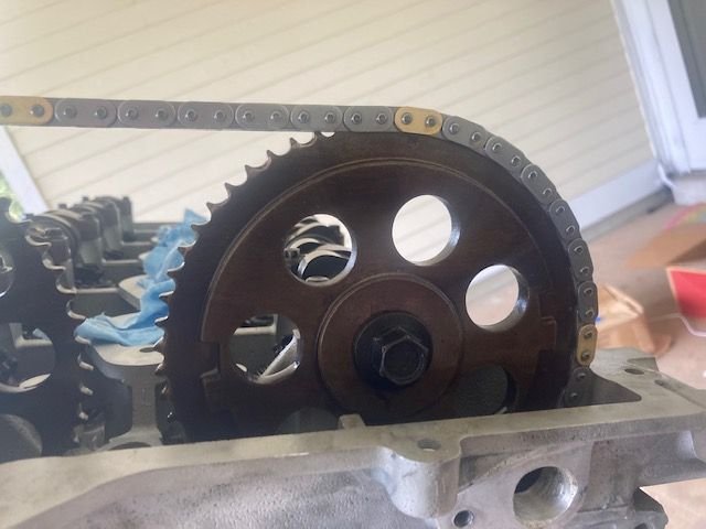

Crankshaft Sprocket & Timing Chain - I reused the same sprocket but ordered a new chain, guides, and tensioner. Make sure one of the gold timing chain marks is lined up with the small "dot" on the crankshaft sprocket (hard to see in this photo, but the dot is located roughly in the 4:30 position, right above the gold chain link).
Ensure one of the gold timing chain marks touches the small "-" or "dash" symbol on the exhaust camshaft sprocket/actuator.
Ensure one of the gold timing chain links is positioned over the small "dot" (located roughly in the 12:30 position in this picture) on the Intake Camshaft Sprocket. Once you have all three lined up (crankshaft, exhaust, and intake sprockets), congratulations, your engine is mechanically in time. While it can be tricky, this can be accomplished without any specialty tools (during a rebuild, that is).

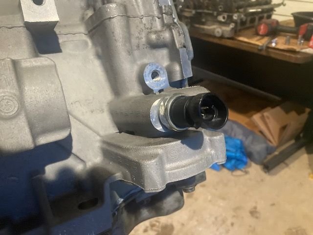

New oil pressure sensor

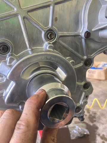

Front oil seal installed
Here is how I installed it, using an oversized socket.

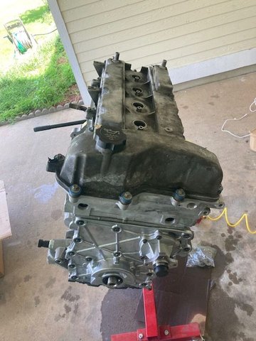

Valve cover installed - cleaning it was done in the same fashion as the oil pan (Gumout Regane parts cleaner, and a brass wire brush).
Another angle.
Another angle.

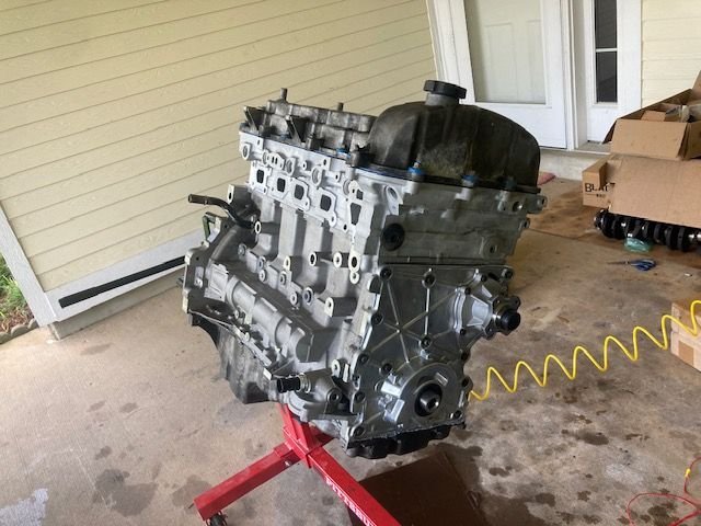

Final Angle - great success, the engine is completely rebuilt!

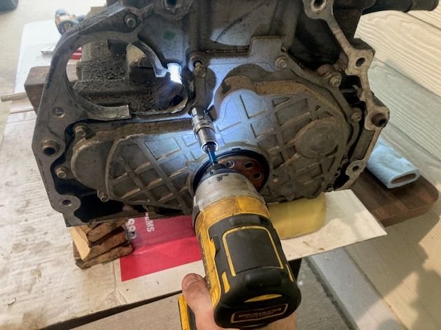

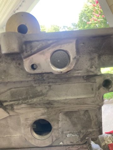

My DIY attempt at drilling out the intake camshaft sensor port; this should only
My DIY attempt at drilling out the intake camshaft sensor port; this should only "need" to be done if your H3 is a 2006 or 2007, and you're using an engine from a 2008+. If this is the case, I would absolutely not perform this task without having an 06-07 head on hand (something that you can use as a template). I could not find a machine shop in my local area that would perform this task, so I did it myself. I used a Dremel Tool, a cordless drill, a lot of drill bits (to work my way up little by little), then took a metal file and smoothed everything out. The final hole I used was a 3/4" drill bit which is slightly too large but it did end up working just fine for me if you put some RTV sealant on the sensor body. 23/32" would be the exact fit for the larger hole. The clearance between the sensor and the intake camshaft sprocket is only 0.045" which you can check with a feeler gauge, so keep filing/trimming the surface down until you achieve this gap. As far as tapping the smaller hole, I simply used a universal tap and die kit that I've had for years. Despite being aluminum, it was a little bit harder to tap than I would have initially thought. I cannot stress the importance of having patience when performing this job; you want to get as close to the factory setup as you can; even having the sensor off center the smallest amount can play games with your engine's ECU timing and potentially throw a CEL code. H3 Humper has a great video on this job (link will be provided below).

3) Variable Valve Timing Problems (P0017 CEL code) LONG TLR BELOW - Oh boy, this could also be a whole another thread in itself, but here we go anyways. After about 150 miles on the new engine of what (seemed) like trouble free driving, one day the car just shut down while idling in my carport. I thoroughly checked all my connections, revisited all of my work, and tried starting the vehicle again. This time, I was met with a very rough and erratic idling and the engine felt like it was going to eat itself. I immediately shut the engine down, plugged in my Scan Tool, and noticed the car had a Pending P0017 CEL code. Now I was really worried that something internally had malfunctioned with the engine.
During the rebuild, I had installed a brand new (non AC-Delco) aftermarket VVT Solenoid, which I immediately suspected was the problem, so I pulled it out, and re-installed the old AC Delco brand sensor. I let the car cool down for about 2 hours, then went to start the vehicle back up. Surprisingly, the problem went away and I thought the issue was simply the new solenoid acting up, so I cleared the CEL codes with the Scan Tool and took the vehicle for a drive just to make sure all was well. I drove the vehicle about 10 miles, stopped for gas, and then the problem reared it's ugly head again. On startup, I was greeted with another rough/terrible sounding idle, so I shut it down, pulled out the Scan Tool, and had another Pending P0017 Code. After letting the car cool down for some time, I was able to start the vehicle up, drive about 10 miles home on the highway with no issues, however when coming to stop, the problem would reappear, and I would have to continually restart the engine until the "problem went away" enough that I could drive it home.
So now I have tried 2x VVT Solenoids, and had the same problem with both. I began thinking about the crankshaft sensor, and wondered if a relearn would help, so I took the vehicle to the Stealership to perform a Crankshaft Relearn Procedure; the idle appeared to smooth out a considerable amount, but unfortunately the problem did not go away, and I would still get P0017 codes and stalls at idle.
I wondered about the type of oil that I was using, as I was running Driven 5W-30 Conventional Break In Oil which is a low detergent, high ZDDP formula, which is non API rated. Up to this point, I had already performed about 8-10 "dyno-runs" (to help seat the rings) with the break in oil, and had driven the car about 200 miles, so I figured it would be a good time to drain this oil, and replace it with my intended oil of choice (Valvoline Restore and Protect 5W-30) to see if that would make any difference.
So I drained the Break In Oil, added the Valvoline R&P 5W-30, and took her for a drive. I was able to drive about 10 miles on the highway at a constant 2200-2300 RPM in 5th gear, with no issues, and then low and behold, when coming to a stop, the car would stall out, and I would get a pending P0017 code. So at this point, I was pretty confident that the problem was only occurring as I was slowing down and coming to a stop.
This is where things take a turn for the better, because over time, with continued driving with the Valvoline Restore and Protect, things eventually got better. After 3-4x more heat up/cool down cycles, I stopped getting the P0017 code completely, but the car would still stall out when coming to a stop after about 10 miles of driving. Then little by little, I found that I could go 20 miles, before the problem would arise, then 30, 40, and so forth and so forth. Now, nearly 700 miles later on the new engine (about 500 of which is on the Valvoline oil), I am at the point to where the problem has essentially gone away completely, and I am able to comfortably drive roughly an hour with no stalls whatsoever. I have not yet tested this on a long trip yet (>100 miles), but for my daily everyday driving, the problem has gone away and the idle is incredibly, incredibly smooth.
So what happened then? Well I realized that one of the biggest things I did not replace brand new was the Exhaust Camshaft Phaser/Actuator, and instead installed a used one into the new engine (remember, this was a 2008 donor engine, that was going into a 2007 vehicle, so I needed a separate 2007 Exhaust Camshaft Actuator); during the rebuild I cleaned the actuator of carbon the best I could, however I did not bench test it with compressed air (didn't even realize this was possible until after the fact when I began researching this problem). When you drive this engine in a mid-range RPM (2200-2300 for example, on the highway), this is the range where the I-5's VVT retards the exhaust timing. Then, upon shifting into neutral, and the engine spools down to an idle RPM, the Cam Phaser is supposed to advance the exhaust timing back to it's "default" 0-degree natural resting position (the position the phaser is in with zero oil pressure).
What I believe was happening, was the Cam Phaser was Sticking/Not moving properly when going from it's retarded position (mid-range RPM on the highway) back to it's fully advanced position (idle RPM), which was causing issues with the PCM's timing, and what was ultimately causing the engine to stall. Essentially, VVT was being activated when the engine is at idle, which was causing the rough idle/horrendous sounds that I was experiencing. Whether there was some internal carbon build up, or some sludge within the mechanism, I do not know, but one way or another, after continued driving with the Valvoline Restore & Protect (an oil known for it's cleaning ability) the problem has all but gone away.
I do not chalk this entire ordeal up to the Driven Break In Oil in any way shape or form, nor do I know if the driven oil would have eventually worked out problem as well, but I figured there would be a better chance of "cleaning" the mechanism with the R&P oil, rather than the conventional Driven oil.
TL DR - Car was getting a P0017 code and horrendous rough idle from time to time. I performed a crankshaft relearn, which smoothed out the idle a little bit but ultimately did not fix the problem. I drained the break in oil and switched to Valvoline Restore & Protect, and little by little the problem went away. While no "definite" cause, I believe the exhaust cam phaser/actuator was sticking when going from highway speeds to idle RPM. It appears that the Valvoline oil has helped clean the Exhaust Camshaft Phaser, and now after about 500 miles on the oil, the problem has gone away.

- Don't buy a dial bore gauge, as you won't need it if your shop performs all the boring/honing - $50
