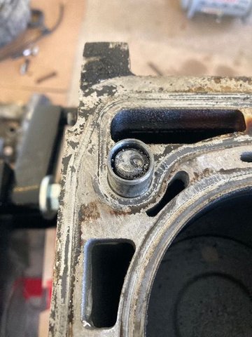

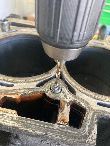

Removing Broken Head Bolts
I used NEIKO 01925A Screw/Bolt Extractor kit from amazon, which includes left handed drill bits and bolt extractors. While there are probably better options out there, it was cheap and it was adequate enough for this task.
I used a cordless drill just to avoid spinning the bit too fast and potentially breaking it. If the drill bit breaks when it is already lodged in the broken bolt, you will be in a world of hurt, so don't get greedy and apply too much pressure/speed to the bit. Just take your time, and you'll be fine. Once the cylinder head pressure is not applied to the bolt's threads, the threads spin almost freely.
Initially, I used a punch to make an indent in the broken bolts just so the drill bit didn't run away when drilling. Be extremely careful not to let the bolt slip when initially starting to drill and damage the threads.

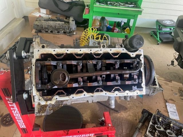

Tomorrow I plan on removing the oil pan, front and rear timing covers, and will start disassembling the bottom end. In a few days, I'll report back with any findings.
If anyone would like more pictures, please feel free to DM me. I had to consolidate most of them due to the 20 photo limit, but I have plenty more available.

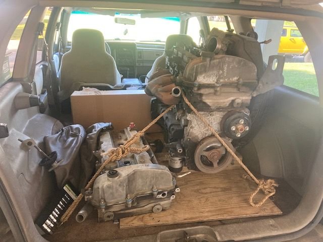

Not bad for $420!
Here it is! 2008 GM 3.7L I-5 Donor Engine loaded into my tried and true 1993 Jeep ZJ. Not bad for $420!

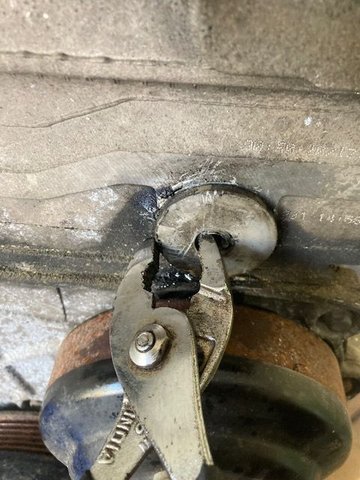

Dont forget about this little buy when removing the cylinder head!
Don't forget about these little guys when removing the cylinder head! They're smaller than the normal sized head bolt, and are located near the front of the engine (near the timing chain).
like this.

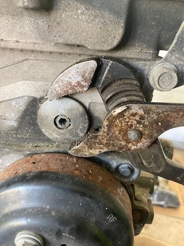

If these plastic caps strip out like they did for me, you can use either a pair of pliers like this.
or like this.  Again, dont gouge the cylinder head.
or like this. Take great care not to gouge the cylinder head.

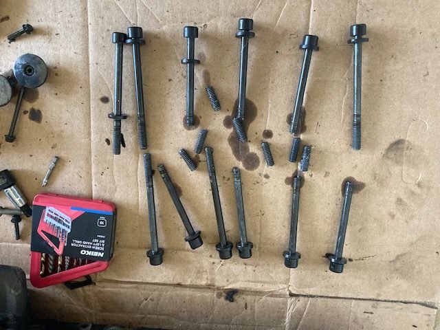

Out of the 12 head bolts, only 5/12 of them survived.  Hey, thats 0.4166, which is at least a better average than most MLB players for their batting averages :-D
Out of the 12 head bolts, only 5/12 of them survived. Hey, that is still 0.4166, which is at least a better average than most MLB players batting averages :-D
This is the kit I used to remove the broke studs.  Not the best, not the worst.  But it works, and its cheap!
This is the kit I used to remove the broke studs. Not the best, not the worst. But it works, and it's cheap!
Start out a punch, then with a #2 drill bit (from the kit), then work up to a #3 drill bit.  Be careful not to drop (too much) metal in the cooling passages.
If the dowel pin gets in your way, removing the broken stud can be a little tricky, but still doable.
Great Success!  Got them all out!

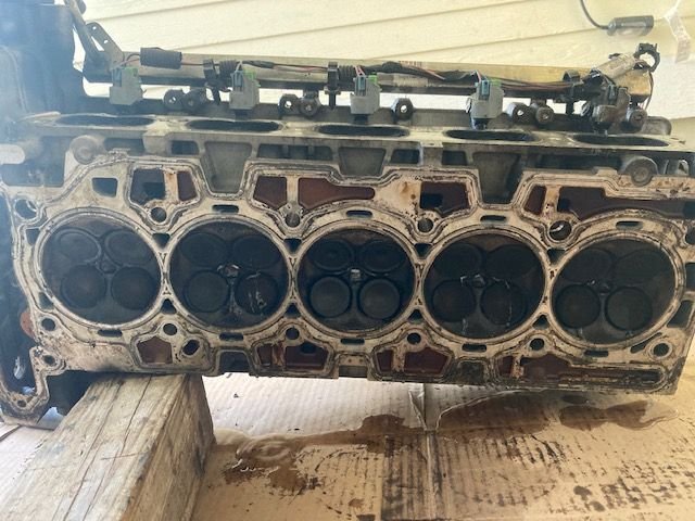

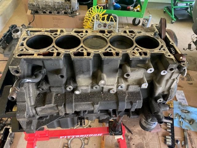

Head off, broken studs removed.  First glance, lot of carbon build up in the pistons.
Cylinder walls look okay!  Might be able to get away with re-using these.
Water Leakdown Test - LOT of water draining from the intake valves.  Adds another layer of confidence to the compression-leakdown test.

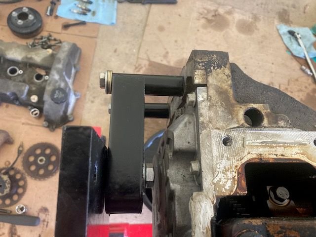

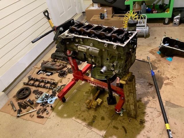

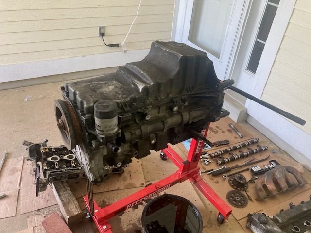

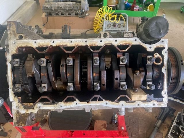

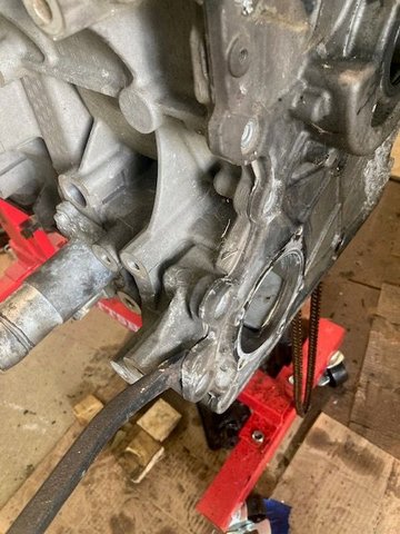

1) When mounting the engine on the engine stand, pay close attention and do not use the mounting holes that are attached to the oil pan. If you do so, as soon as you unbolt the oil pan, the oil pan will separate from the engine, and the engine will only be held up by 2x bolts on the engine stand.

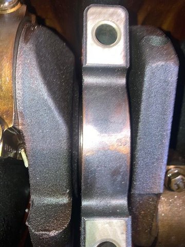

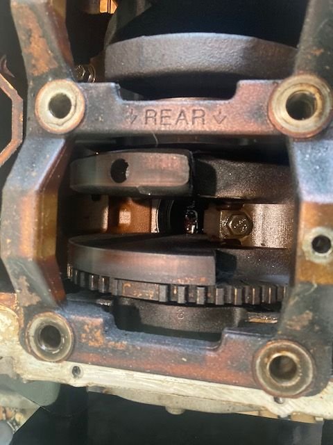

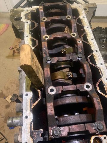

2) In order to fully remove the crankshaft and the 2x balance shafts for inspection, the rear timing cover plate must be removed, but cannot be removed while the engine is still on the engine stand. That is, you’ll need some other type of work bench/table to set the engine block on, then remove it from the engine stand, in order to remove the rear timing cover.

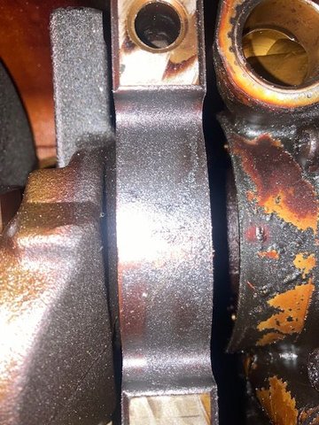

3) Balance Shafts are VERY delicate. More on this in the later section.

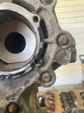

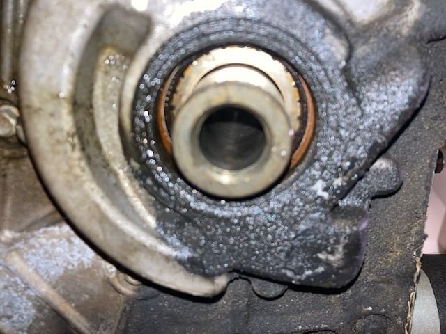

4) Cylinder Sleeves - After closer inspection of the sleeves in this engine, unfortunately I will be unable to use them and they will need removed and replaced. Buying the “proper” tool for this (Kent Moore EN-45680-400/450) is not cheap.
5. Balance Shaft Bearings call for another expensive tool for removing/replacing them (Kent Moore EN 44225). The cheapest I could find is $800; that said, I can probably manage with a much cheaper $85 Camshaft Bearing removal/installation tool from Amazon.

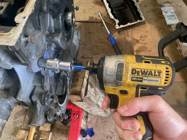

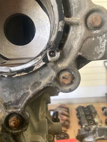

Water Pump - remove all the bolts holding it in place. One of my bolts broke (go figure); in order to remove it I drilled with the #2 drill bit (same kit as before), then used the #3 bolt extractor and got it out.

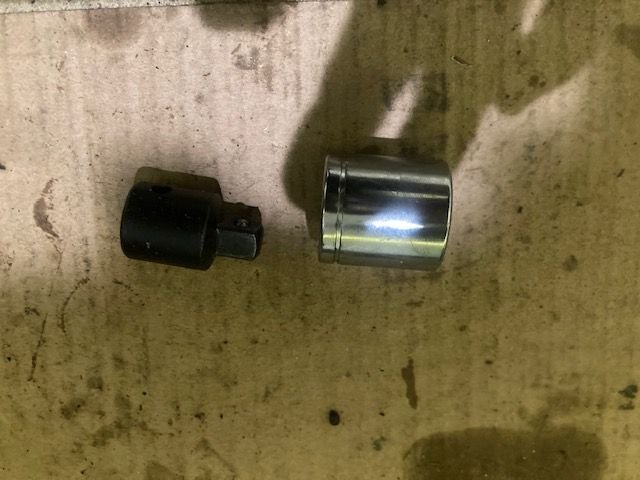

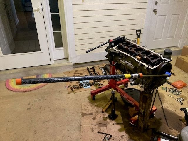

Harmonic Balancer Bolt - This was the first major roadblock I hit in this project. This sucker is TIGHT!
In order to get ANY torque on this stubborn bolt, you’ll need to jam something against the connecting rods or crankshaft weights so the engine will not spin. I used some pieces of wood, and jammed it against the connecting rods, which held the engine in place nicely. I would strongly discourage anyone from using any hard pieces of metal to hold the engine in place; wood worked just fine for me.
Use a 15/16" impact rated socket. 24mm is just a bit too loose for such a high torque application.
I first tried the impact wrench, which didn’t loosen the bolt whatsoever. This was with one of the strongest Milwaukee Impact Wrenches on the market, on the highest setting, with a fully charged battery.
I tried a 24-inch 1/2” Breaker Bar and put every ounce of strength I had into it. 200-300 lbs of force, pressing straight down on it. 400-600 ft-lbs of torque, but the breaker bar did nothing at all; absolutely nothing.
I eventually took a break, then decided to go get a 36" cheater bar from Lowes. I taped the steel pipe about 1/2 down the 24” breaker bar, then took it a step further and put tape over the breaker bar 1/2” drive (in case it exploded, I didn’t want debris flying all over the place), and even wore gloves and eye glasses for the same reason.
Here we go: round #3 with this bolt.
With the pipe about 1/2 down the breaker bar, that meant there was about 3-4 feet of leverage (compared to 2’ originally). Roughly 600-800 ft-lbs of torque. I put every ounce of strength I had into the cheater bar, and I was sure the 1/2” drive was going to explode at one point. FINALLY, I heard.........a distinct “click”, followed by an ever so small amount of movement.
I kept the force applied. I felt more movement, then.....smooth motion? Surely I had stripped the bolt head...
Nope...all there, and I could finally start truly loosening the bolt without fighting for my life. And eventually, I got it off.
Mission Accomplished. Bolt Removed.

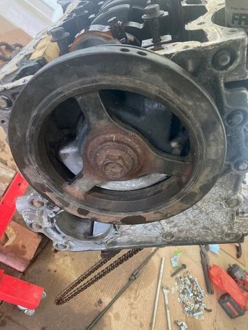

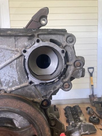

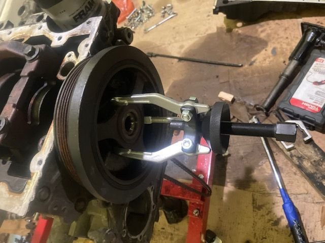

Harmonic Balancer Removal
But what about removing the balancer itself? If you have a Harmonic Balancer remover, then life should be fairly easy. If you don’t have one like me, this is how I removed it using a slide hammer kit.
I purchased a Maddox Slider Hammer Kit from Harbor Freight about 6 months ago for rebuilding a Jeep axle. It has a “3-claw” option for the slide hammer as well, so with a little improvisation, I made a jerry rigged harmonic balancer remover (see pictures).
Fortunately, this was not nearly as difficult as removing the bolt, and the balancer came right off. And there was absolutely no damage to the face of the crankshaft
More great success! Small victories! Onward!
Setting the Engine on the Work Bench - You’ll need to do this in order to remove the rear timing cover (as previously mentioned). Put the engine on a work bench, disconnect it from the engine stand, and remove the rear timing cover.
Removing the Balance Shaft Timing Chain Tensioner/Chain - Remove all the required bolts, then remove the timing cover. This will allow you to access the balance shafts, tensioner, and chain.

As mentioned previously, these balance shafts are extremely delicate; DO NOT even think of trying to pry them out on the “metal” flange attached to each one, where the bolts tighten them to the engine block). While I originally envisioned this section of the balance shafts being made out of steel (which bends before it snaps), these are made out of a cheap cast material that appears to have sand as one of the main ingredients.
This flange section of this part is extremely, extremely brittle, and I originally chose to try to pry out the balance shaft on this section. I put a pry bar up between the flange and the engine block, and with a tiny, tiny ounce of strength applied, this section of the balance shaft snapped right off. Considering this material is designed to mount the balance shaft to the engine block and prevent it from backing out, it has almost zero strength whatsoever, and I almost don’t trust it for that one simple task.
So instead of prying out the shafts at this location, pry them out by the balance shaft gear itself,
Now I faced a problem: how do I reattach this broken piece to the balance shaft? I almost convinced myself that I could get away with JB weld, until I took a break, drank some water, got some rest, and started to think logically again by reminding myself that this is going into a Car Engine, and that I will not take chances on something like this (what if it failed while my wife was driving and caused a catastrophic failure?) So I started calling welders in my local area to see if it could be welded back together; as it was, not a single welder in my town believed that delicate of a material could be welded back together.
So now my only options are to 1) get another balance shaft (extremely expensive on ebay) or 2) try to disassemble the balance shaft and replace the broken part on my current balance shaft.
So now it came down to seeing if I could remove the bolt and gear from the (driver's side) balance shaft. I was able to use an allen key to prevent this piece from spinning on the shaft, then I used some channel locks to grip it and hold it into place while I applied torque to the bolt.
The impact wrench was unable to loosen the bolt, so I tried a breaker bar. After a few attempts at getting the bolt to move, the bolt eventually snapped.
So out came the bolt extractor set, again. I first tried the #2 left handed drill bit, then I was once again able to pound the #3 bolt extractor into the hole, and managed to get the bolt to move.
But something was wrong; when trying to loosen the broken bolt stud, it was going deeper into the balance shaft, not coming out.
Then it occurred to me, it is a “lefty tighty" bolt; that is why the impact didn’t remove it, and the bolt broke.
Seriously, did GM actually try to make this the most poorly constructed, overly complicated piece on this entire engine? Then discontinue it so you have to work extra hard to try and find a replacement, all while saying in the factory service manual that you should not “disassemble the shaft assembly” if you want to repair it?
Sorry, rant over. I tried to figure out why they would have chose the bolt to be a righty-loosey bolt, and I think it came down to the direction of engine rotation. If you’re looking at the rear of the engine, the engine spins counter clockwise, as do both of the balance shaft gears. If this were a “lefty-loosey” bolt, there is a chance this counter-clockwise rotation could loosen the bolt, and cause the gear work it's way loose. Because the passenger side balance shaft gear (not the shaft itself) spins counter clockwise as well, I’d be willing to bet that it is a “righty-loosey” design as well (did not put this theory to the test).
Regardless, I eventually got the broken bolt out using standard right handed drill bits, since the bolt extractors were designed for lefty-loosey bolts; I got there eventually, but wow what a pain that turned out to be.

Onward to the cylinder bores; remove the crankshaft, connecting rods, and pistons (from the top of the engine, not the bottom).
Main Bearing Brace Bolts - These are tight, but doable. A 24” breaker bar worked for these, then once loose, an impact driver was used to remove them the rest of the way. Unfortunately, these are “torque to yield” bolts and they cannot be reused. To make matters worse, on Rock Auto they are ~$36 for a pack of 10, and unfortunately you need 12. Get ready to spend $72 on bolts!
Once you get all the bolts out, go ahead and remove the bearing brace and set it aside. Make note that during re-installation, the direction matters, so make sure you install it exactly the same way you removed it. Fortunately, you’ll find the words “REAR” engraved on it to make it easy for you.
Cylinder Bore Inspection
I purchased a $50 dial bore gauge from Amazon with a 0.0005” tolerance with decent reviews. According to the Schwartz manual for the 3.7L engine, the tolerance for these bores is 3.7623 - 3.7629”. In theory, a 0.0005” would not have an accurate enough measurement for this engine, but I figured I could start at 3.7626” (right in the middle), and with a 0.0005” tolerance gauge, one “tick” mark would put you at 3.7621” or 3.7631”.. If the bore is +/- one tick mark away, that is still extremely close to tolerance, and I figured I could use a magnifying glass to get a closer inspection if able. If the test came out to be outside of 0.0005”, regardless of how expensive of gauge I’m using, that would mean the engine’s cylinder sleeves would be out of tolerance and would ultimately need replaced.
I grabbed my bore gauge, calibrated it with the help of some 3-4" micrometers, and went to work; before I even got the gauge into the cylinders, it became apparent very quickly that these cylinder sleeves could not be reused. After closer inspection, it was evident that this engine suffered from oil starvation at some point; enough that the cylinder sleeves themselves suffered from a pretty decent amount of scoring, especially on the thrust sides of cylinder walls.
Looking at the pistons revealed the same thing; plenty of carbon build up on the pistons except on the thrust sides where they were a lot more shiny due to scoring.
This explains why the compression was suffering when I performed the leak-down test; not only were the intake valves leaking, but so were the piston rings/cylinders. After examining them, it is very clear why.
I did eventually perform a dial-bore inspection of the cylinders just for the heck of it; the frustrating part is that every cylinder near TDC passed the inspection, and was essentially right at 3.7926" (right in the middle of the specific tolerance). However the lower you went, the more the cylinders went out of tolerance due to the scoring. Had this engine not been starved of oil, I get the feeling the cylinders would have held up just fine.
Main Bearings Inspection - More signs of low oil/oil starvation, especially on cylinder #3, which the bearing was actually pitted pretty badly.
Wrapping Up This Section - It is very clear that this engine was in much, much worse condition than I originally thought and is going to cost more than I anticipated. That said, I believe there are several silver linings to this project.

Broken Water Pump Bolt - use a #2 left handed drill bit (from my kit listed previously) then the #3 bolt extractor and you will get this little guy out.
Draining the old oil.  Look how nasty that stuff looks!  LOOK AT THAT!
Before removing the oil pan, ensure that the engine mount is NOT attached to any of the threads that are attached to the oil pan.  Otherwise, when you remove the oil pan, bad things will happen.
See how these are not attached to the oil pan?  This will work!
Hard to believe that this was once used to contain oil.  Gross stuff.
Harmonic Balancer Bolt - The tightest bolt Ive ever encountered as a DIYer.
Harmonic Balancer Bolt - The tightest bolt I've ever encountered as a DIY'er.
Wedging wood up against the crankshaft to hold it in place.
Then slide it down in deeper.
Tape (as protection) in case the breaker bar drive decided to explode on me.
This is the setup I used to remove this stubborn bolt.  Wow!
Great Success!  Look at the size of that thing!  Unfortunately, I've had trouble obtaining a new one.  Looks like I'll have to reuse this one.

Bearing Caps: Pay Attention to the number, as well as the direction of which way to install them.  The arrow is pointing towards the FRONT of the engine.
Maddox Puller (used the claws to remove the harmonic balancer)
Socket Assembly
Socket Assembly
Does it work?
Does it work?
Hoorah!  It works!
Hoorah! It works!
No damage to the crankshaft from the socket!
Bearing brace!  Recommend not removing this until AFTER removing the rear timing cover, balance shaft chain, and the balance shafts.  By keeping this installed, it helps keep the crankshaft tight, which helps to loosen the balance shaft chain.
"REAR" indications on the bearing brace.

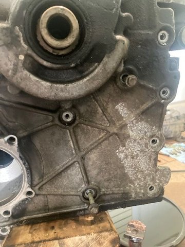

On the front timing cover, these two bolts are longer than the rest.
Good pry location for the front timing cover
More grossness!  What the heck kind of oil did this person run in this engine?
