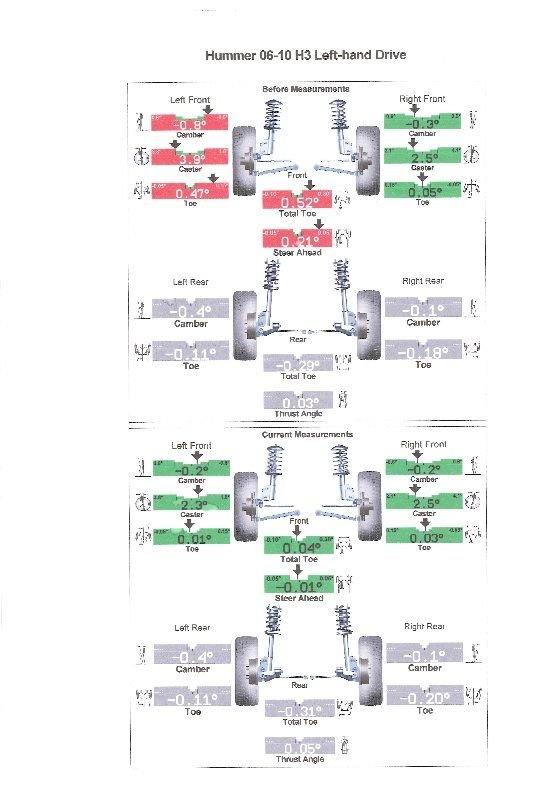

I’ve got an 07 h3 with 167k miles on it. I’ve had the alignment done, had it checked again two other places and it’s all good according to them but my steering wheel still has to be turned a tad to the left to go straight. Any suggestions?
Old Jun 19, 2022 | 04:30 PM
Posts: 9,017

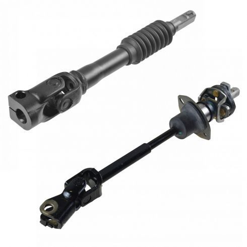

Post a picture of your alignment printout & check steering shafts u-joints.
Old Jun 20, 2022 | 10:52 AM
They do not care what position your steering wheel is in and can cheat on you alignment by that lack of care.
