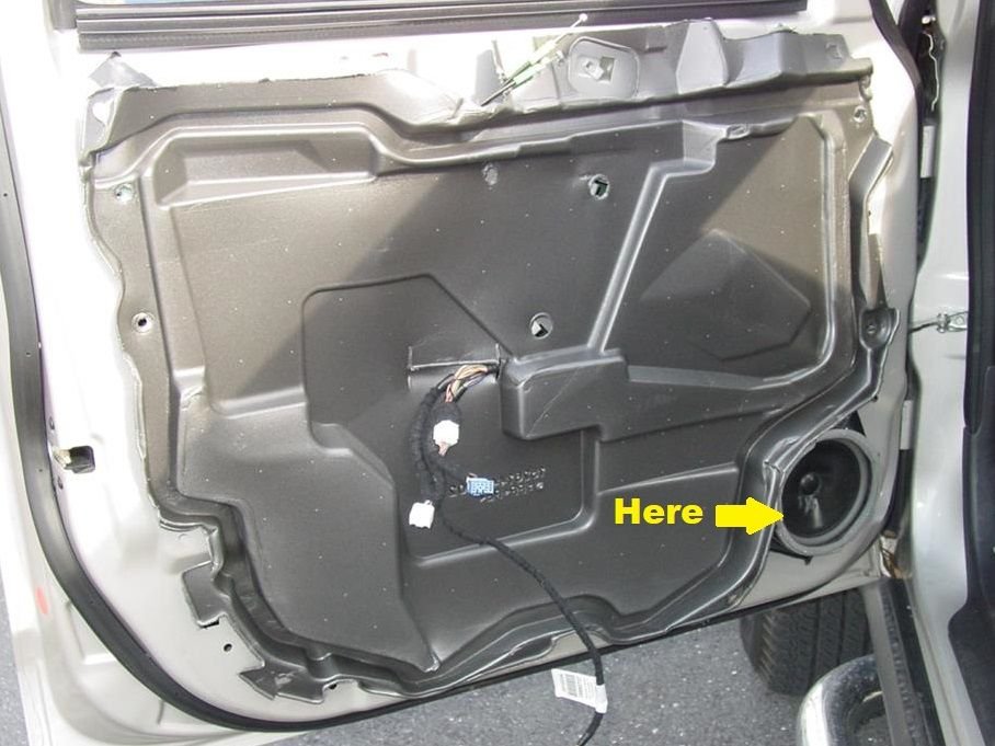

A few weeks ago chime stopped working and Onstar volume is very low. Can't adjust very hard to hear.
Does anyone have a fix for this?

I've never used Onstar? However, I've asked Cortana for assistance. If your chime stopped working, check the drivers door speaker, could be related to the Onstar volume.

Door speaker or driver side piller speaker?

Turn the radio on and put your ear next to the drivers door speaker.

Can't hear anything in that speaker. All others are working.

Driver side door speaker is where the OnStar chime and all other chimes is sent to.
You most likely have a blown speaker. Might as well replace all 4 door speakers because the rest are going to go also.
