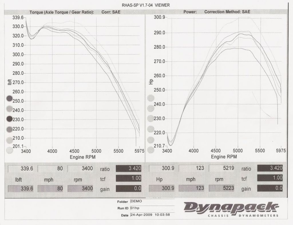

You won't be having a manual very long because the Aisin AR-5 is rated only up to 260 ft-lb of TQ.
This dreamer thread is really quite ridiculous when as I said before, you can buy a V-8 Hummer. Who in there right mind would spend $7K (before install costs) on a I5 Turbo/SC kit? Not to mention the L52 and LLR are not particularly boost friendly, and you can use an SC/Turbo H3 as your coffin when you die because the only way to get rid of one is to give it away.
The LH8 (I have no dyno info for the LH9 but that would be irrelevant so long as we use 87 Octane Gas not E85) can put OEM flywheel numbers (300HP and 330TQ) to the ground with very basic completely reliable mods. Bone stock the numbers for an 09 LH8 Colly are 223HP & 253TQ at the rear wheels.
This is what one of our intakes, a PCM tune, Efan conversion, and a high flow muffler does for a 2009 LH8 Colorado can do. Add a cam, add 22 more. There are dynos of SC LH8s that do no better, but the HP curve is pushed a tad forward. The SC/Turbo I5s, not even close.
