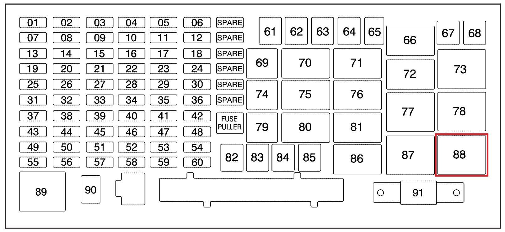

Old May 7, 2023 | 04:41 PM
Posts: 9,018
Remove relay #88. Post the results.

2007 H3: Interesting about the radio comment. The little round black silicone plug that surrounded the drivers side key hole rotted away allowing water to get into my door after a heavy rain. That’s when I noticed a static sound coming out of my radio. On and off it would come on. Pulled the weather strip around the bottom edge of the drivers door and made sure all the water was drained. Inserted a black o-ring into the key hole and secured with some black gasket sealant to stop any leaks. Per HummerZ recommendation, I pulled the #88 relay and disconnected the negative battery terminal to reset the computer. Cleaned the relay connection, reinserted the relay and no more radio issues. However, my rear view mirror is now dark and no longer shows the outside temp reading. Maybe an issue of water in my door. Sorry for the long winded comment, but wanted to include in case anyone else had the issue with the leak around the keyhole. Happy Mothers Day😀
