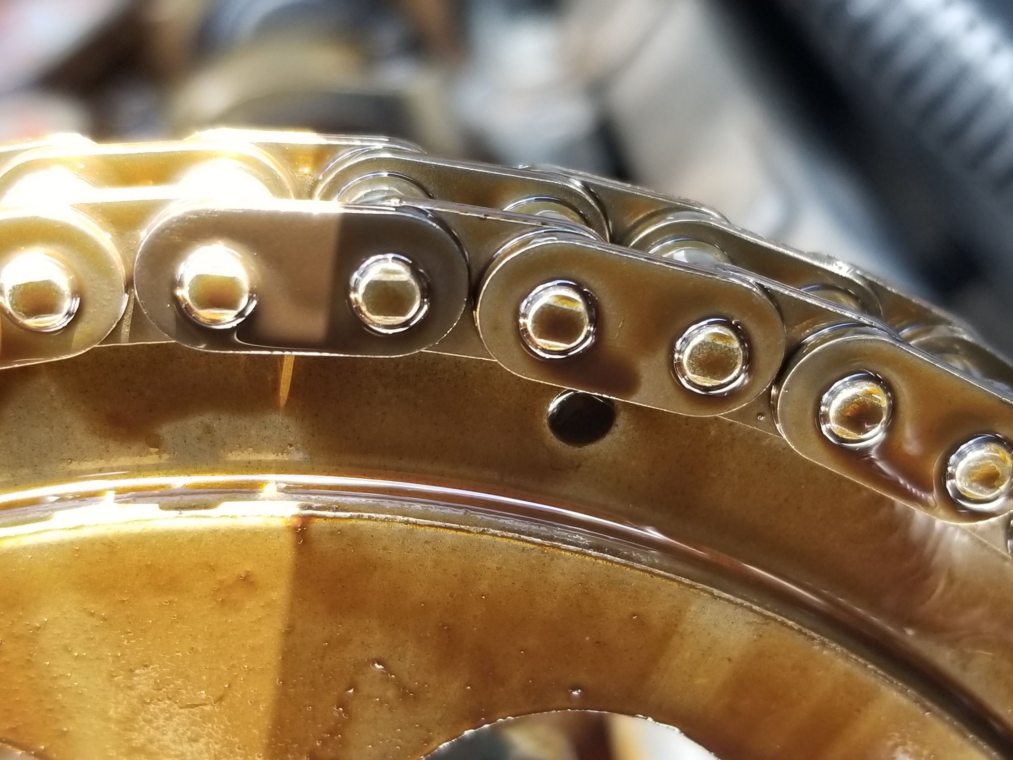

No, she didn't see the temp. But I justed pulled the cover back of to verify timing, and it looks like it jumped a tooth. How hard it that to fix with a chain? I've only ever done belts.
Old Sep 19, 2018 | 11:28 AM
Well, the dark timing link does not line up with the mark on the sprocket. How many miles does it have on it?
Doing the front chain and tensioner (might as well look at the chain guide too while its apart) is possible w/o pulling the motor or trans.
Long and methodical job, no short cuts, and you need a couple special tools to do it. Click my link in blue.
3.5L Link for the engine manual
