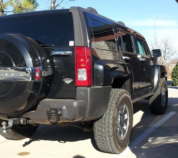

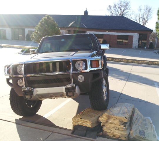

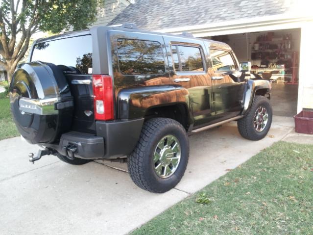

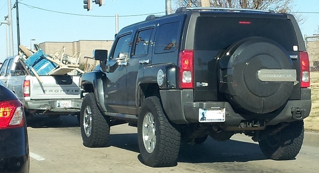

Default 295/70/18 Nittos
I have 295/70/18 Nitto Terra Grapplers on factory 18's.
I wanted the stance as close as I could get it to the 2006 H3x concept, which means a 35" tire that isn't obviously oversized and too wide. I love the way they look but the ride is pretty rough.
I found out after I'd bought them that they have a load rating of 4080 lbs!! That's WAY too much for an H3, even if it is an alpha. Even if you run them at 30 psi instead of their suggested 50psi (which I do) you still feel every bump in the road; their ride quality is honestly on par with the run-flat's I run on my 350z.
I would recommend the 325/65/18s if you want 35s and a smoother ride because they (oddly) have a load rating of 3200 lbs, which is what I had on my '07 H3 and it rode like an Escalade. A 275/65/18 would probably look good too if you wanted a 33".
Here are some pics. The first picture has the 295 in the front and 265 in the back (I was testing out plastidip on the spare).
