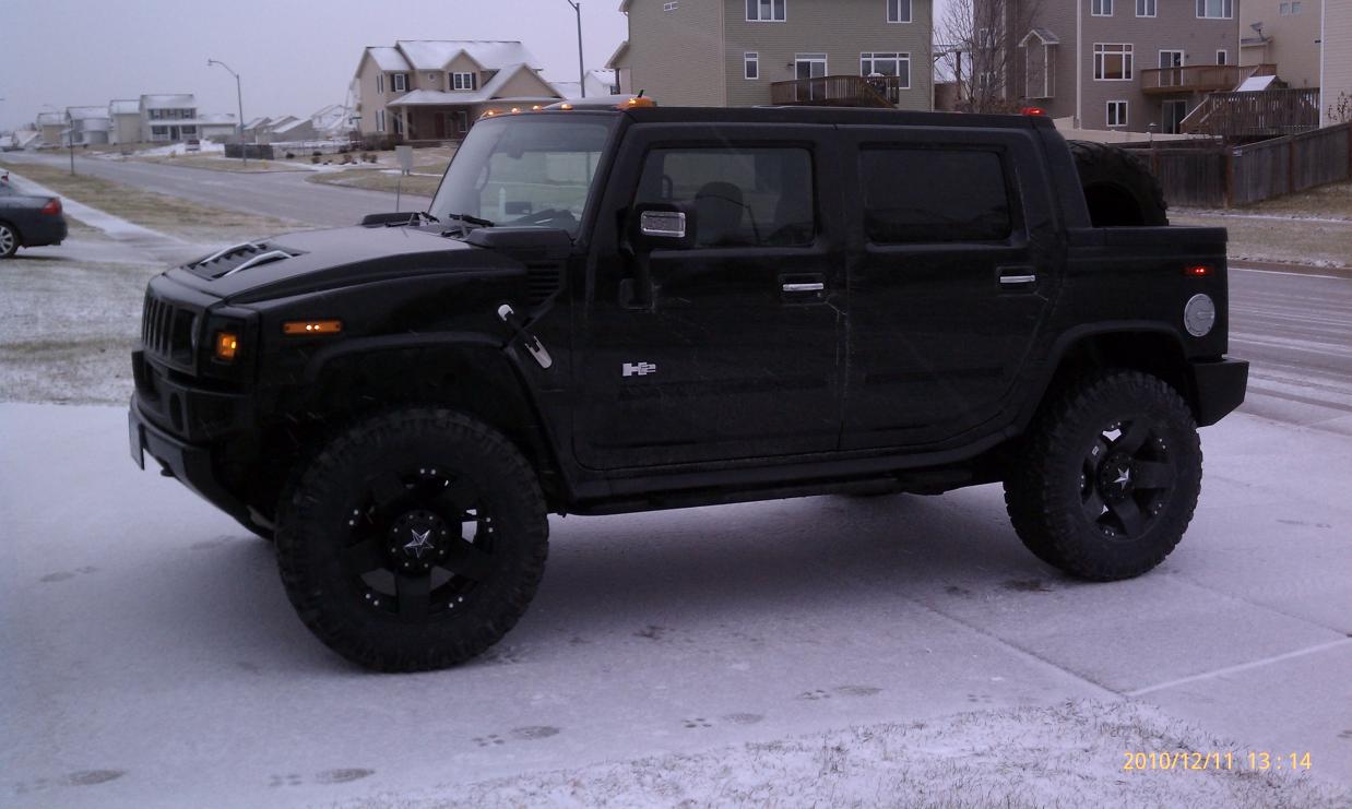

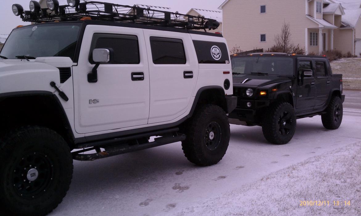

New Nitto 37" Nitto Trail Grapplers, going to put the ready lift on soon.
Attached Thumbnails 35" or 37" Nitto Trail Grapplers on 20" xd rockstars-j-b.jpg   35" or 37" Nitto Trail Grapplers on 20" xd rockstars-2007-37.jpg

I have minor rubbing now turning just around town, just depends on excact tire size and your rim size. My 2" lift should fix that.

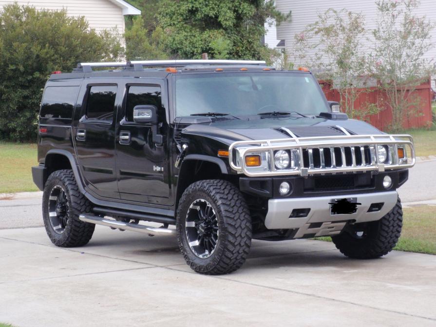

I don't have the Rock Star wheels, but I do have the Nittos on 20 inch Incubus Crushers
Attached Thumbnails 35" or 37" Nitto Trail Grapplers on 20" xd rockstars-p9260295.jpg   35" or 37" Nitto Trail Grapplers on 20" xd rockstars-p9260008.jpg
