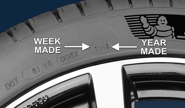

11yrs old and only 2 owners?.. Replace the tires.

11yrs old and only 2 owners? - yeah i know rite? Local trade-in at the porshe dealership
Tires could be out of balance... they look relatively new
Old Dec 8, 2019 | 08:21 PM
Posts: 9,018
check the dot's ...

For sure I will look in the morning! Thanks Hummerz
Old Dec 8, 2019 | 08:33 PM
Posts: 9,018
Btw, you could also measure the tread depth inside/outside/center.
