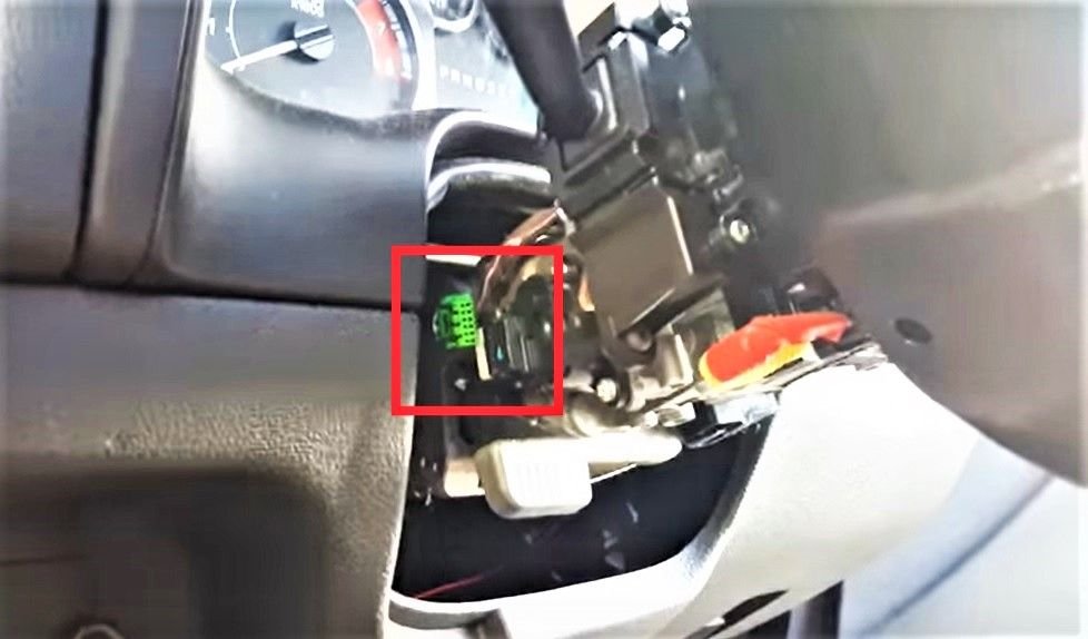

OK, then spray the ignition switch with CRC. Pics courtesy of hummerz.
