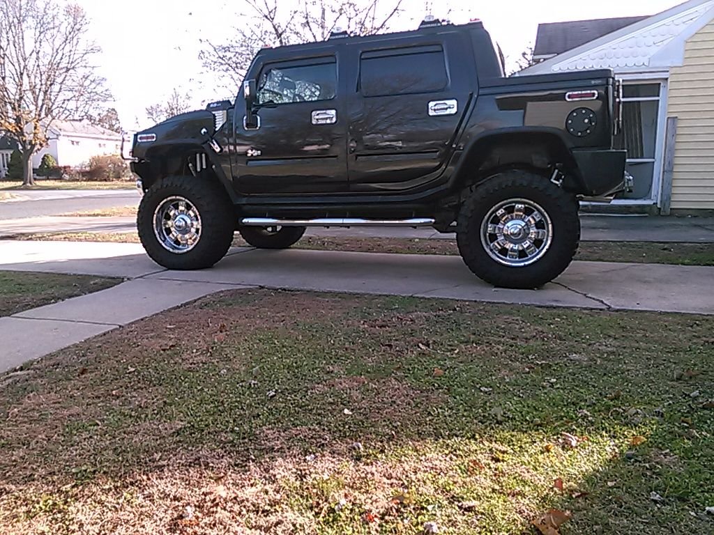

Very good question. I've owned a 2005 H2 SUT, which I purchasd with 210,000 miles on her. Now, I own a 2009 H2 SUT, which I purchased with 150,000 miles on her. Far as know, the 03 to 07 H2's have the 6.0L engine, which some people refer to "The Forever Engine", because of it's reliability. Of course, every engine has its issues, but those 6.0's were something special. Transmission. I beleive the 03 to 07 H2's were equipped with the 4-speed automatic tranny. The 08 to 09 has the 6-speed auto. I was able to talk to a former GM engineer online. He explained to me that the transmissions were always the weak point in GM trucks and SUV's but if you upgrade to the proper valve body component, which should have been installed in a GM transmission from the beginning, you should get plenty of long life in her as long as the previous owner(s) took care of the vehicle. Interior, the dash is toitally different between 03's to 07's to the 08 and 09 models. Me personally, I like the more rugged look of the dash system in the earlier model H2's. Both generations of the H2's will have there fare share of electrical demons to deal with. Most of what I've experrienced were control modules failing, mainly the modules controling the radio and/or climate control. So far, for the 09 model I have, the control module for the doorlocks likes act up every now and then. I can go on-and-on about these H2's. I hope this helps a little.
My 05 model H2
My 05 model H2

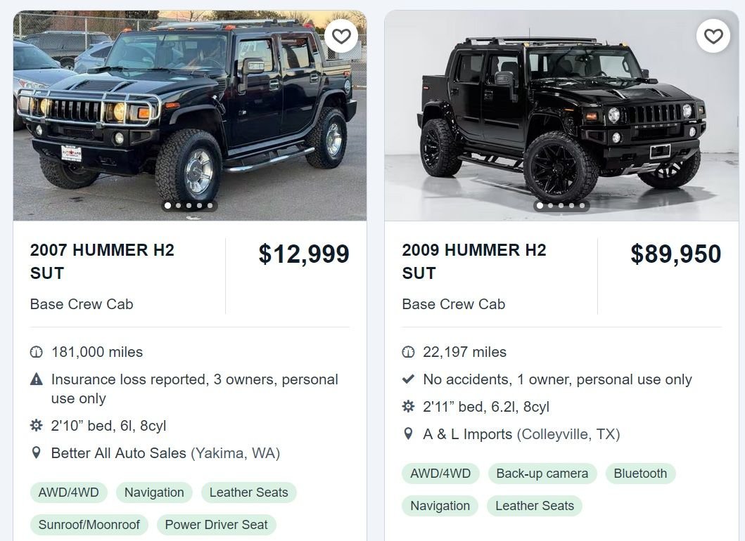

Taking a look at the latest auction prices from BringaTrailer.com, prices have been coming down off the pandemic highs. 08/09 vehicles are the rarest ones to appear. Mileage and year affect price. $50k+ vehicles are typically under 50k miles, and are typically an 08/09. Although this year... the highest priced vehicles on this site were low mileage 2004s... which is very odd. The highest priced auction at nearly $80k was a 2009 duramax conversion.
