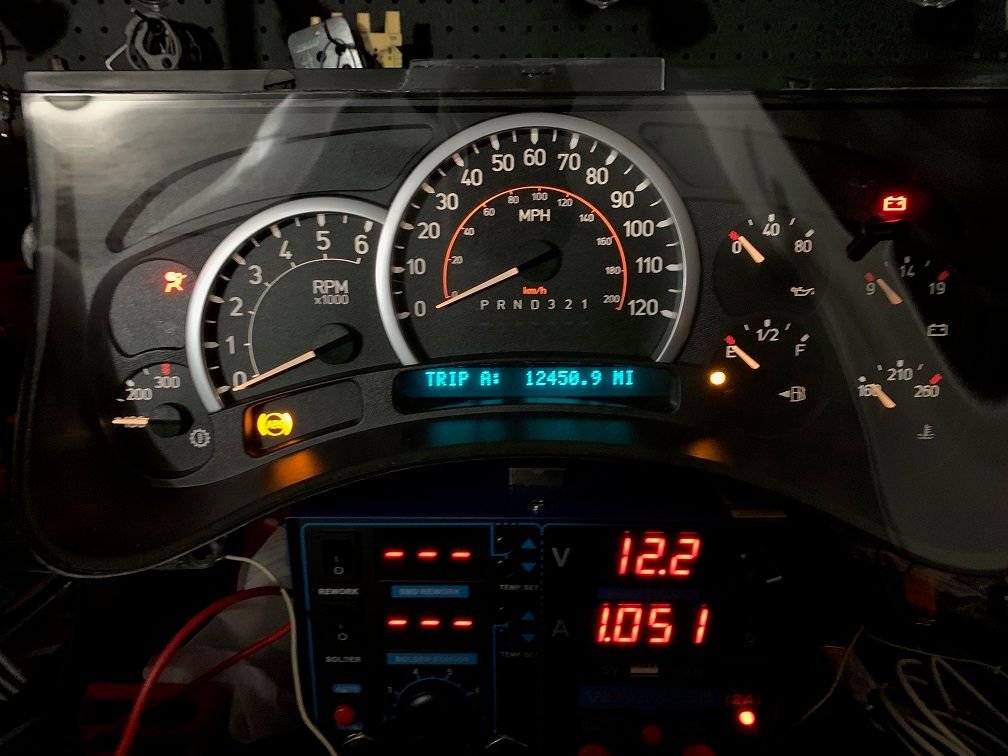

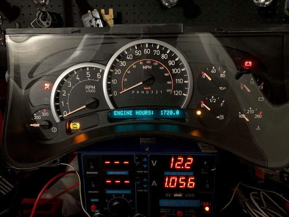

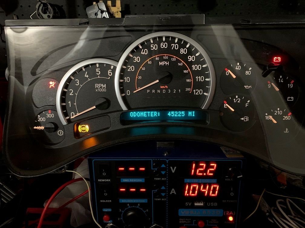

I have a cluster from an 06 that was cleaned, and serviced back in 2020. It shows 45225 and 1720 hours on it and is in excellent condition and 100% factory, no mods. I might be coaxed into letting go. PM if your interested.
Here's some pictures from when it was serviced:
