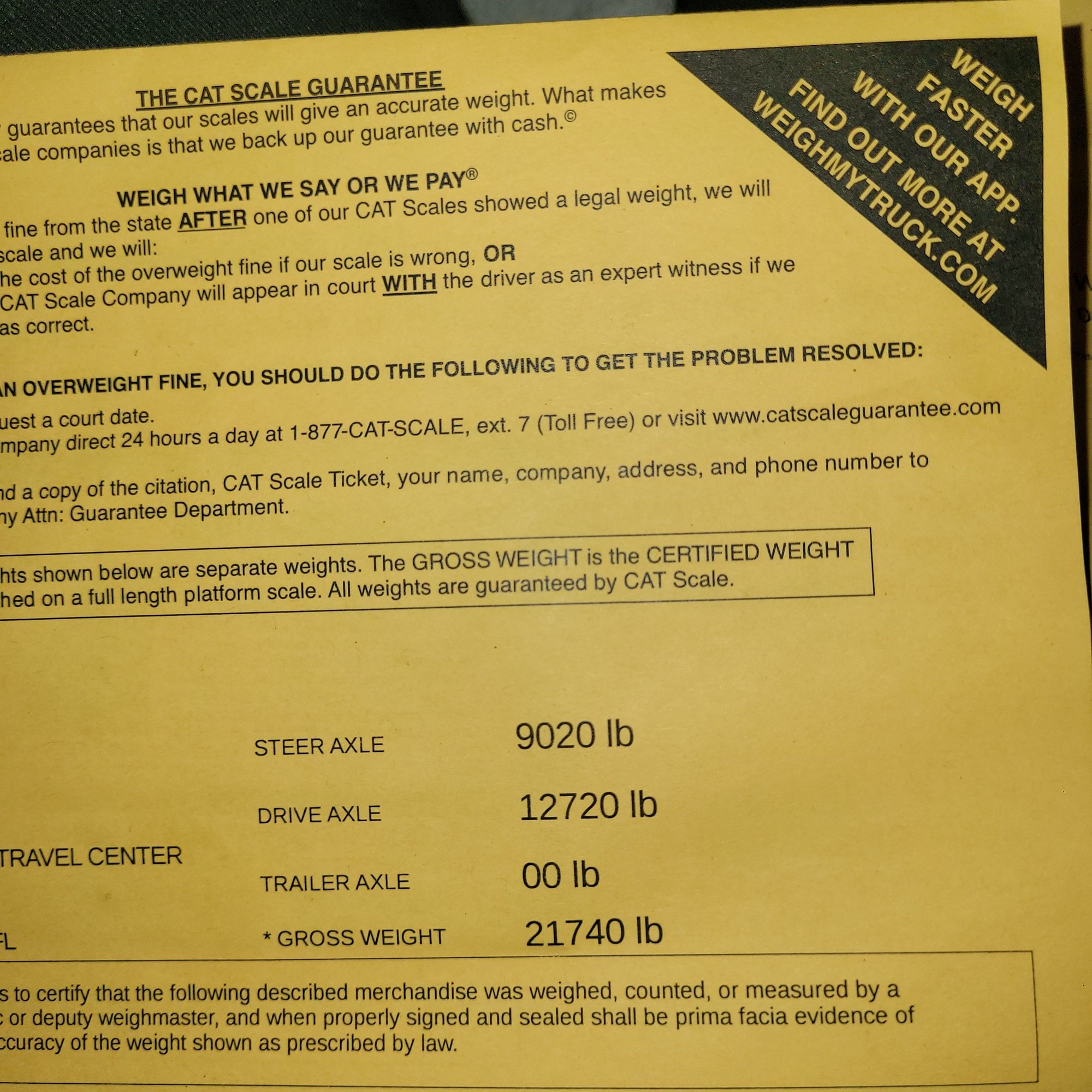

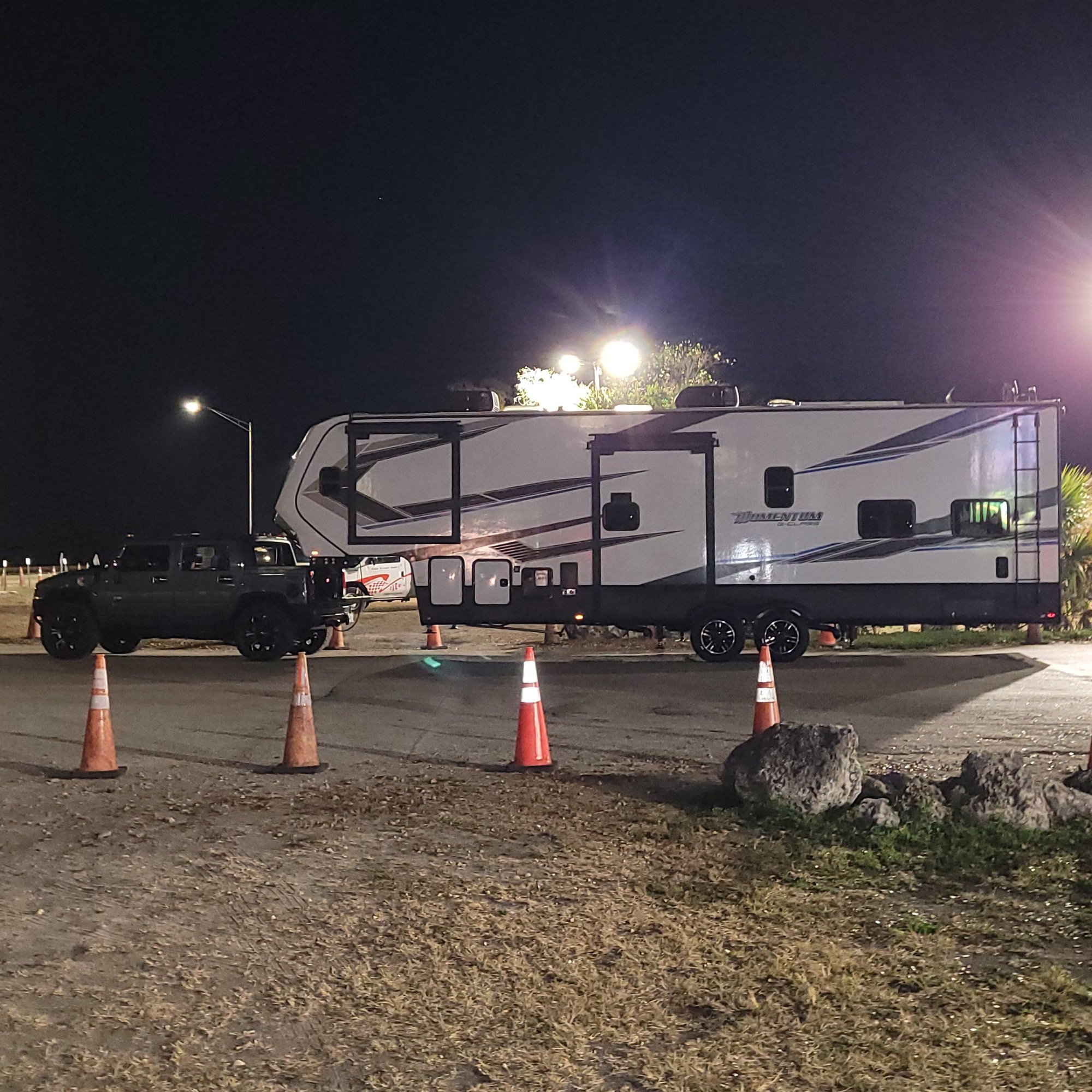

PUTTING A 5TH WHEEL SUT TO WORK PULLING A 36' GRAND DESIGN TOY HAULER
SITTING MOSYLY LEVEL WITH 2440 LBS IN THE BED
SITTING MOSTLY LEVEL WITH ONLY A 2" SQUAT, 2440 LBS IN THE BED
GRAND DESIGN TOY HAULER. TOTAL GVWR 21,720 LBS.
KINGPIN WIEGHT OF 2440 LBS.
TRUCK TIPPED THE SCALE AT 9020 LBS. SLIGHTLY OVER GVWR, BY 420 LBS.
PULLS WITHOUT A PROBLEM, AND I DON'T USE TOW MODE.!!! GOTTA LOVE IT..!!

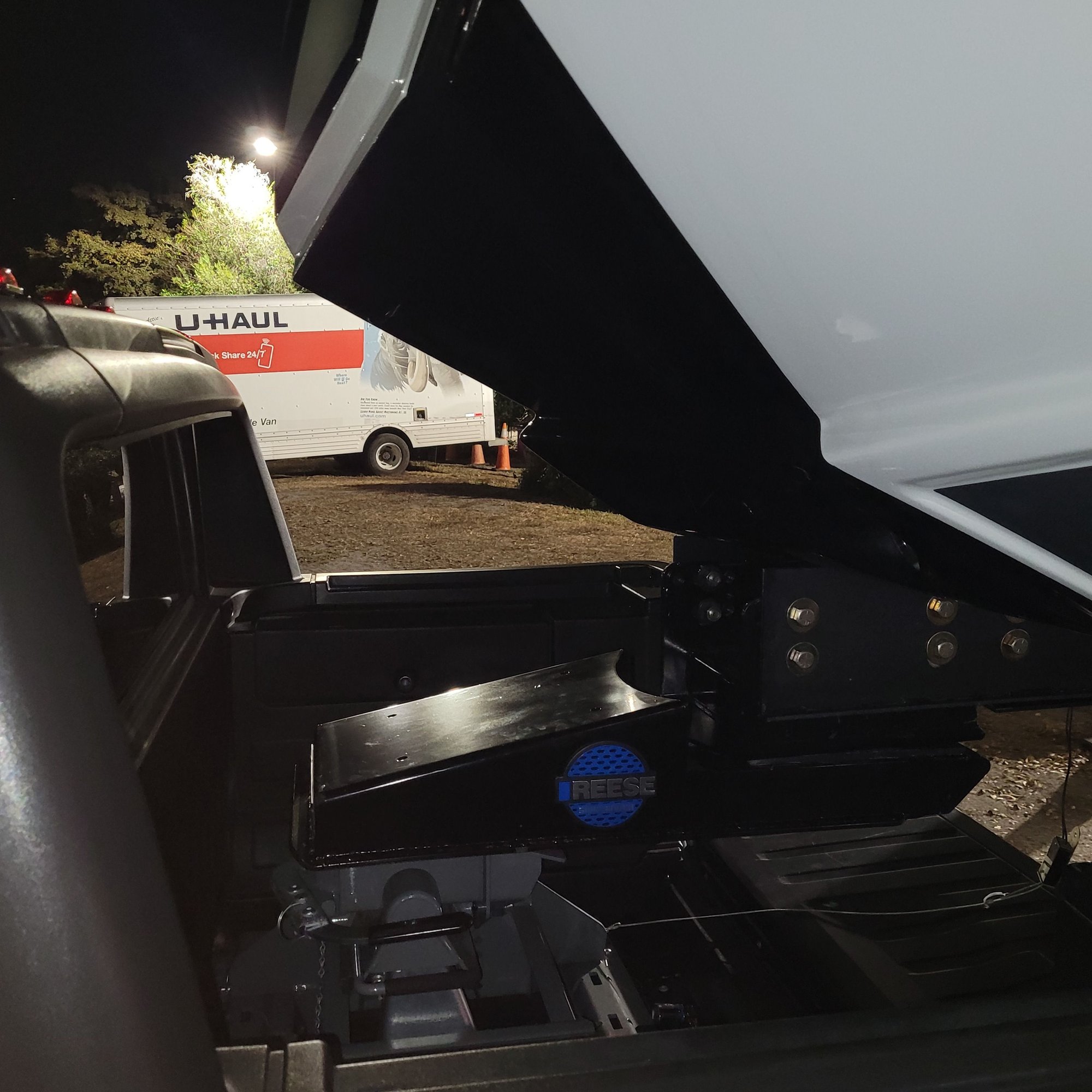

HAD TO EXTEND THE FRAME PINBOX WINGS 12", ALONG WITH USING A REESE SIDWINDER ADDING ADDITIONAL 22" PLUS 12" OF CLEARANCE.

HITCH..SIDEWINDER...PINBOX EXTENSION

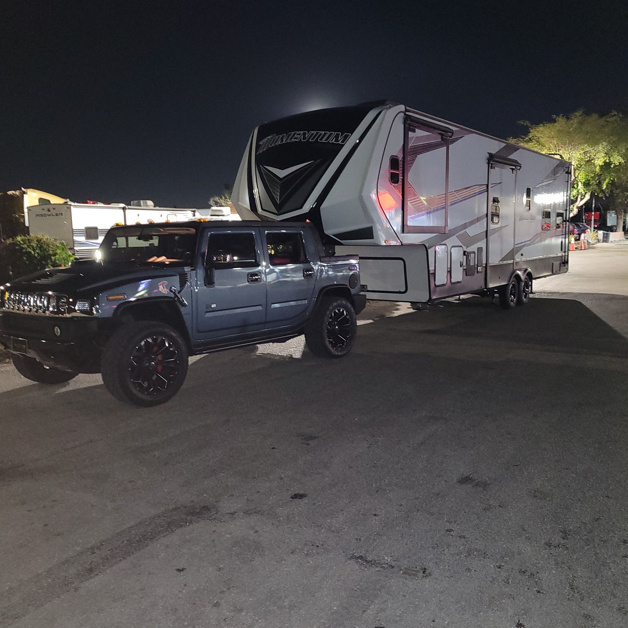

THESE SUT'S ARE NOTHING SHORT OF...TOUGH..!!!
