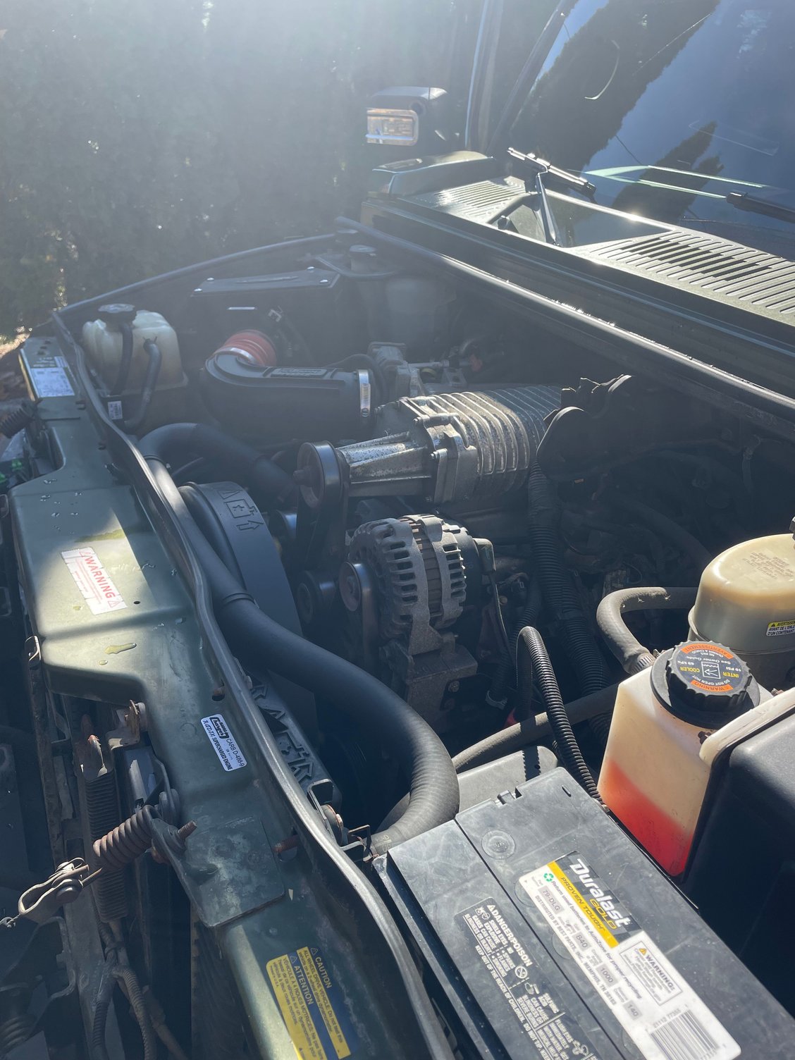

From all the reading I and research I did before I purchased my H2 I was worried about power. Well now after my purchase I am very pleased with the power this 6.0 put out. 😉

Are superchargers on our Hummers not hard on the transmissions.

Numb, that is pretty neat to have a supercharger.

Very hard on them.... our transmissions (4L65E) are already strained due to the weight of the vehicle and typically only last to around 150k miles without a supercharger. I've seen others with superchargers reporting going through a transmission every couple of years. That being said, a 4L65E can be rebuilt with much better and stronger parts to handle 500hp but you need to find the right shop that knows what they are doing to build one right that will last when the time comes to replace it.

Yes I would say the supercharger will be hard on the tranny. When the time comes I feel I will have it rebuilt to a tranny that can handle it.
