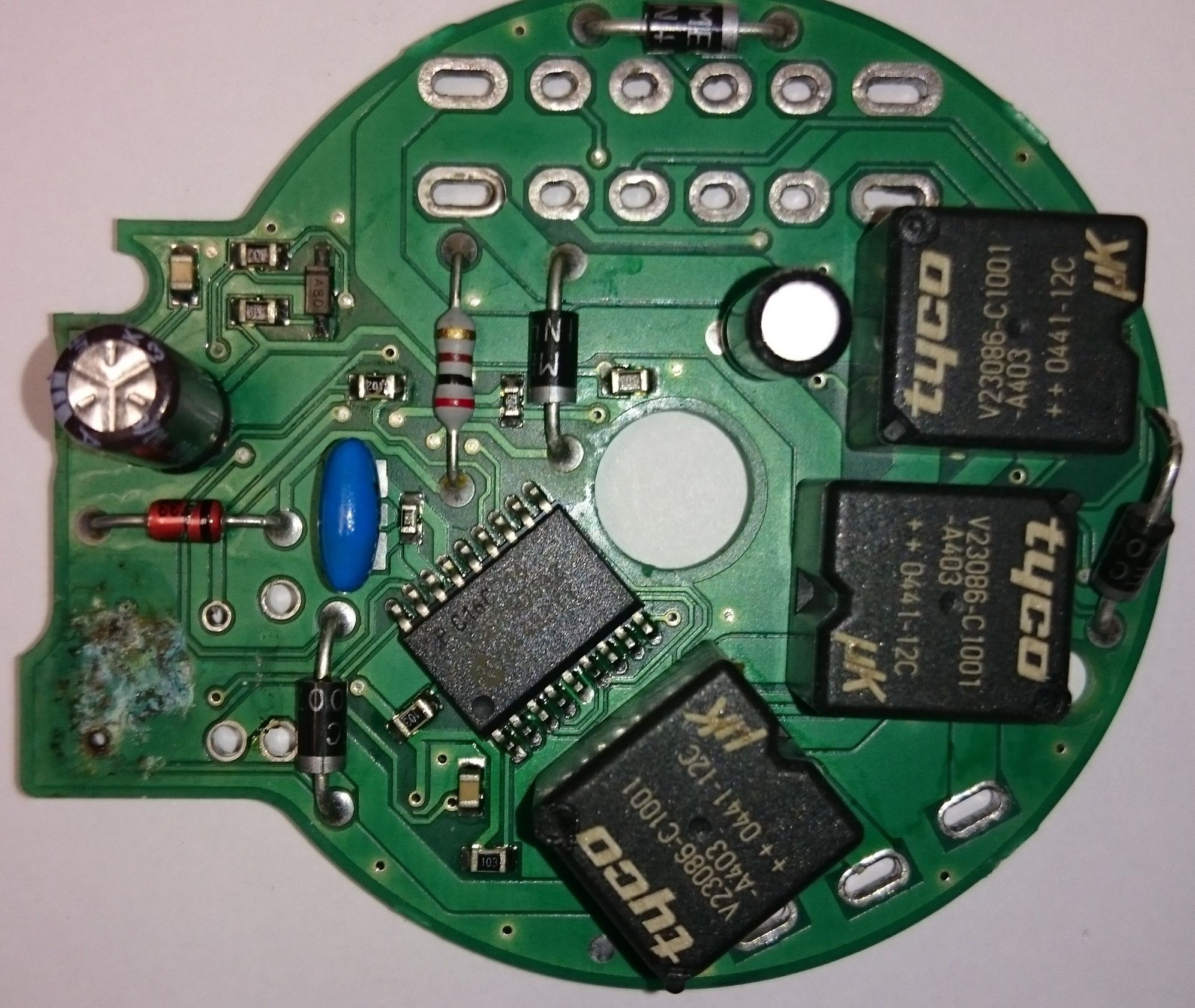

I replaced the wiper pulse board under the cowl and the issue has not returned so far. The old one I removed had white crust on the board like it was corroded from moisture. I kept it as a backup for now. Removing the cowl was way easier than I thought. It is just screws, bolts, and pressure pins.

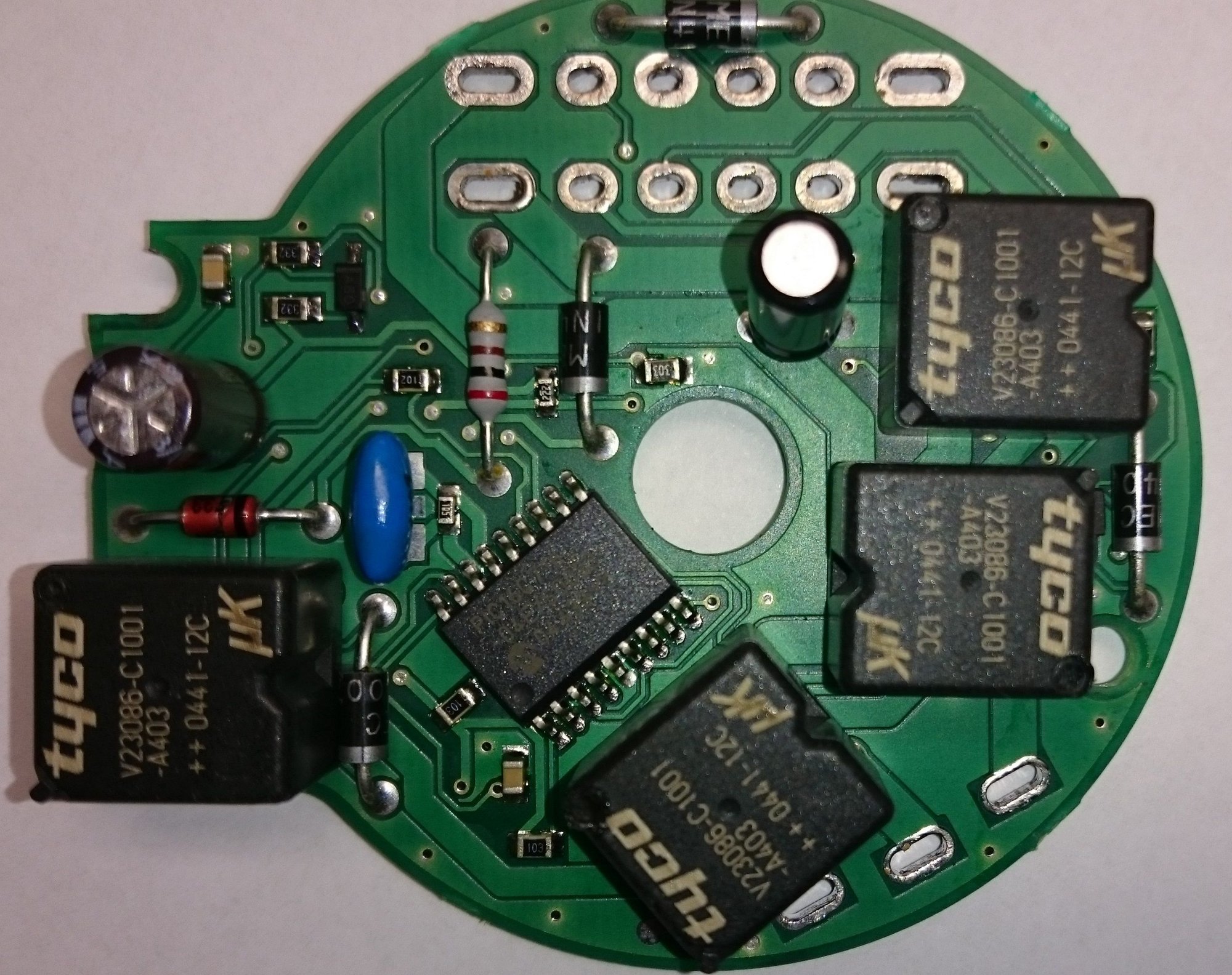

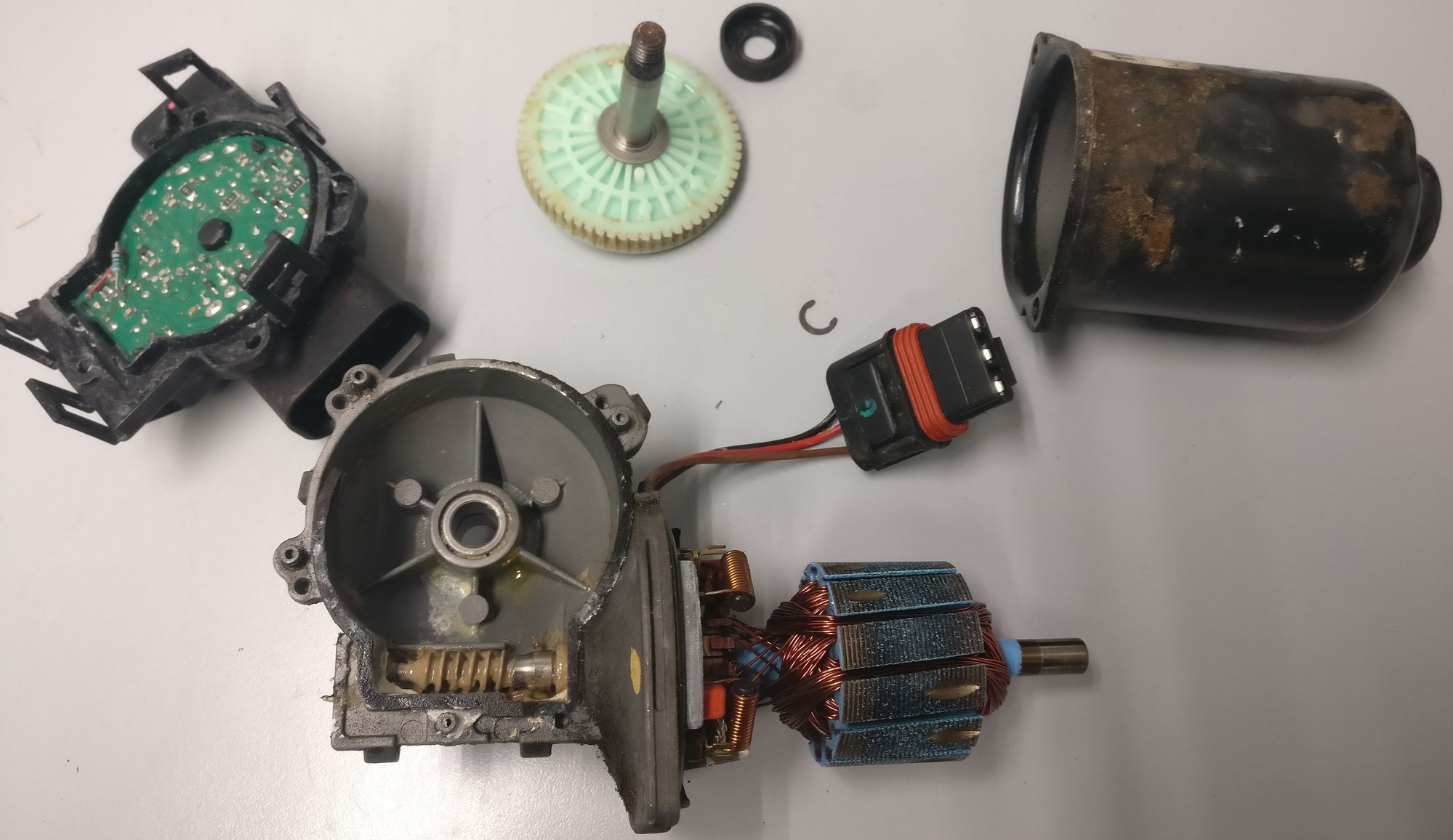

I'm probably the unlucky one, in my case there was no visible signs of corrosion to the pulse-board. So I de-soldered the PCB from the platic housing, removed a relay and found the tracks had been eaten away underneath. After reparing the tracking, replacing a resistor, re-fitting the relay, re-fitting the PCB it all worked fine for about 18 months. Eventually the motor seized as the previous damp had corroded the bearings ( which by the way are replaceable too)
After doing all this work I just wish I'd bought a complete new motor in the 1st place.
So my point is YES the Pulse Module can be cleaned, repaired or replaced but whilst you're there check the bearings and grease and re-lubricate. Better still, avoid a "dog's breakfast" and just buy a new wiper motor unless you really are broke.
