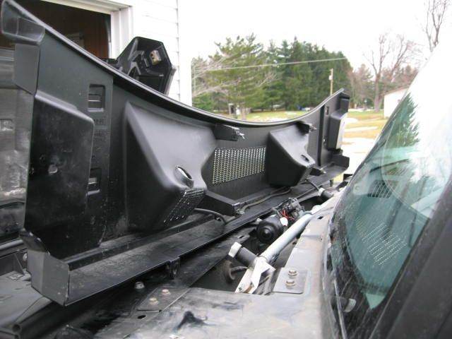

so i disconnected the line that is in the engine bay, and i tried the washer fluid switch and the fluid comes out fine. so then i blew into the hose that seems to go towards the nozzle and put it back together. i ran the windshield washer switch again but nothing comes out of nozzle, and then i heard washer fluid leaking around the wheel bay area for both the front driver and passeneger. so i assume the line is cut that goes to the nozzles or it came off. anyone know what i have to do so i can get access directly to the feed side of the nozzle?

i just read about people saying to blow into the hose to maybe push out any debris out of the nozzle. now i think the hoses that goto the nozzles are disconnected or were disconnected before because when i run the washer pump with all the hoses connected i hear leaking. so im wondering how can i take apart the front end or where do i acess from so that i can see the hoses that connect directly to each nozzle?
Old Nov 19, 2019 | 06:39 PM
Always blow back to clean the nozzles! Now you need to look under the cowl to reconnect the hose. Make sure those nozzles are clean before you reinstall!
