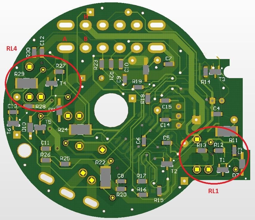

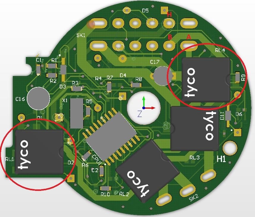

Pulse PCB images:-
You can see the corrosion underneath RL1. This PCB was repaired but 2 years later the motor bearing went so a new motor was fitted.
Complete replacement pulse-modules are avialable here.
