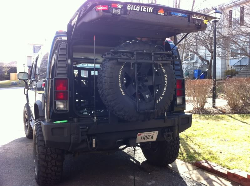

I installed the Cobra 75 WX ST 40-channel CB a few years back. It has a small box that you can tuck in the dash or console somewhere and all the controls are on the handheld. Then I mounted my Firestiks on the tire carrier...one on each side of the spare.
