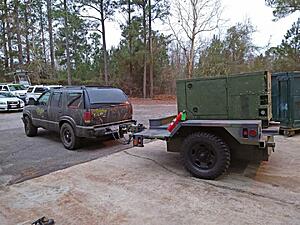

  #570
Nice! If you want to lower that it is doable. I did with my military generator trailer. I got a pair of basic GM 8 lug HD truck steel wheels (painted black) and put some 33's on for one. Then we removed the pointless gigantic shocks (I and others cannot figure how those shocks were in any way useful), notched the bars and raised the axle up a few inches. If I remember right that torsion axle is rated for 7000lbs. Now I can even reasonably tow it with the little Blazer (still have to use a 6 inch lift bar on that). Overall reduced the deck height by about 7 inches. Tows great and is just easier to deal with now. I did also have to remove the big steel wheel from the bottom of the jack so that would still be usable (could just get a different jack) which is fine since the wheel was not really useful to me. ON the H2 was original height with the HMMWV wheels, mid shows where I cut and welded to raise the axle, last shows new height on little Blazer.
Probably also reduced the overall weight by a couple of hundred pounds too with those very heavy shocks and massive HMMWV wheels and tires swapped although the 803A genset weighs about 1200lbs by itself and I added a custom aluminum belly tank to the trailer as well (can see that hanging down in the last pic). With the tank full the total weight is close to 4000lbs and it still rides and pulls great. It is an LTT-HC trailer which is near identical to what yours is, just configured for generators.
