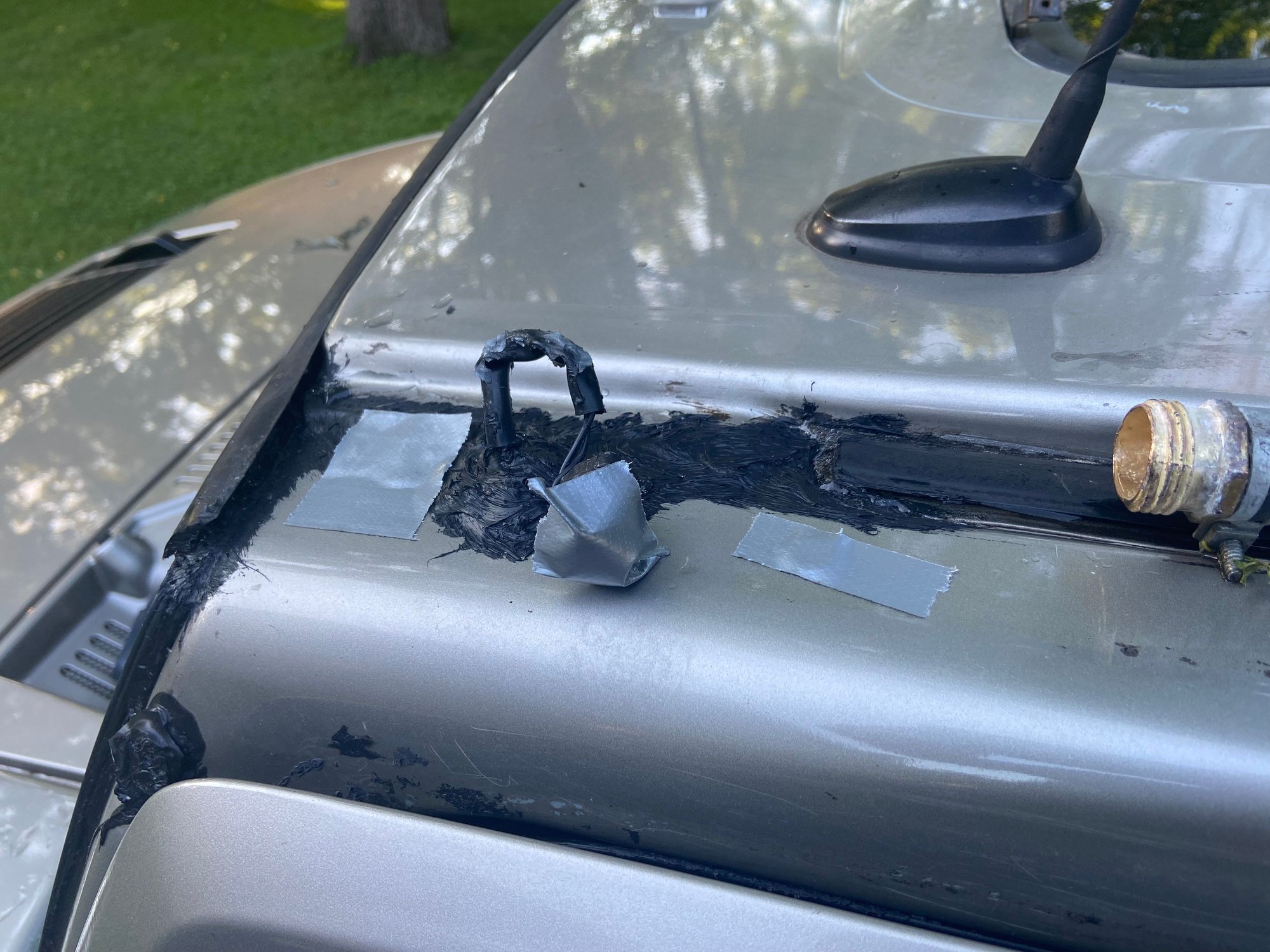

Thank you all for the reply's. I sealed my windshield without luck. Still leaked as I ran water. I then took off my roof rail on the drivers side including the front and rear corner light looking for a seam like MixMan suggested. Could not find any real reason for water to leak in. I then found a small seam from the front of the windshield past the front side marker light. I saw a ever so fracture of the seam. As I do I sealed the sh*t out of it using RTV sealant. Ran water over it for 45 minutes no leak. Waiting for a good rainstorm to really check before I put it back together. Thanks MixMan I think this solved it. The pics below show where I sealed it.
On closer look I may have to trim some away so My corner light fits properly. I used RTV because I had it on hand.. Will this work...or should I use seam sealer? I dont want to have to do this again.

Great you found the source of the leak. Not so great looking, and RTV is NOT an adhesive!
Permanent solution is to remove that mess, and get a quality self leveling seam sealer, also tape it off to make a nice clean professional look. GL
