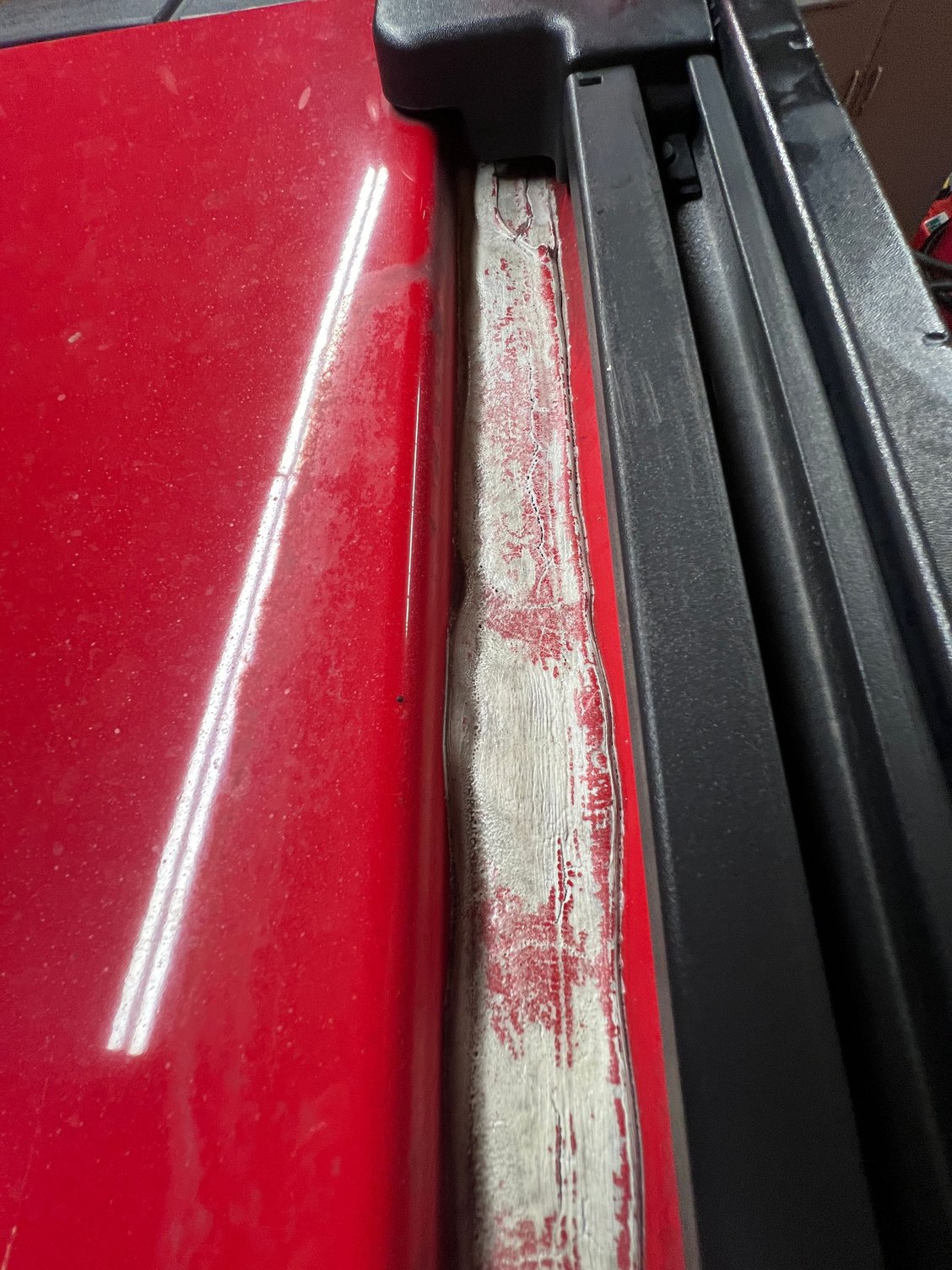

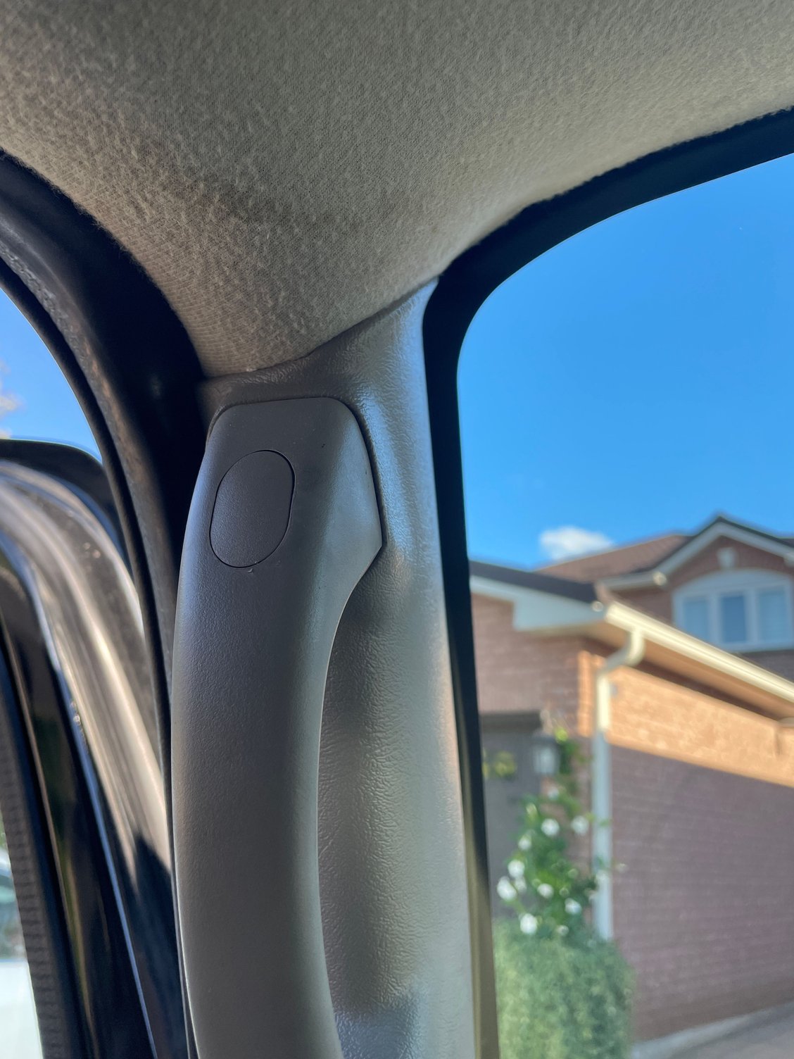

That’s the area the water leaks from, it’s starting to ruin the headliner. I’m going to bring it to the dealer and hopefully they can figure this out. I’ll keep you posted

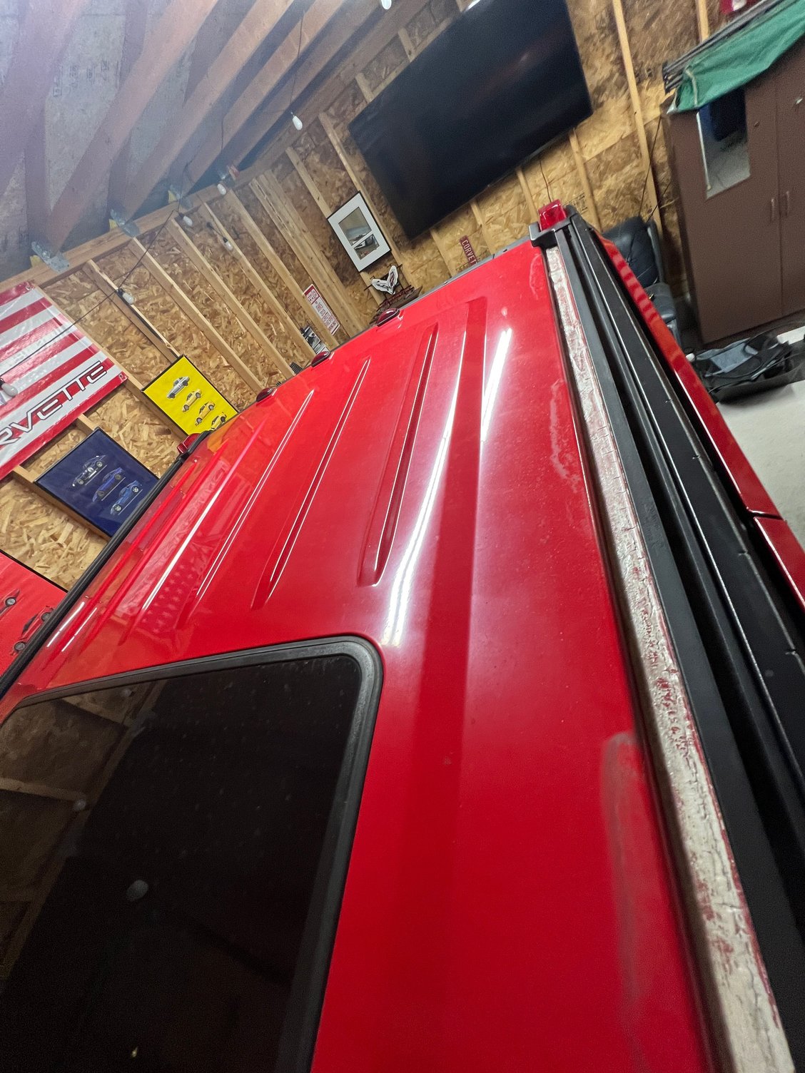

Old Sep 9, 2021 | 08:36 AM
Might have to pull the roof rack side rails off and reseal the body seams under them.... I did that on mine. If so get a tube of proper 3M body seam sealer, dont just put any plain silicone there for that as you want to be sure it seals and lasts.

Are the roof rails easy to pull off? That’s has to be the issue

Old Mar 23, 2024 | 01:28 PM
07SUT's Avatar
Joined: Jul 2022
Posts: 11
From: RI
Check roof rails. The paint cracks and can cause leaks, put RTV along the the seam or some sort of sealant.
