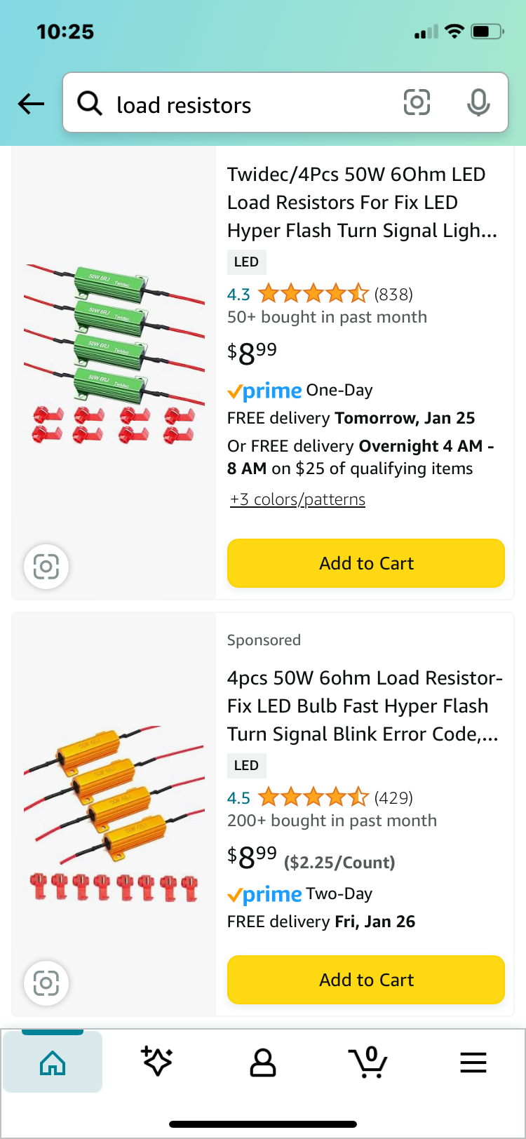

Start with putting load resisters on your turn signal LED’s first.
Any load resister works imo.
I’ve load resisters added to my company pickup trucks and my own business truck for over 5 years now.
Sometimes you have to replace the LED’s as they start flickering cause they are cheapos from Amazon.
I myself have all the lights on my H2 replaced for LED’s not only the bulbs but the whole unit 4 months ago and added only resisters to the front and rear signal turn lights.
So far so good.

When it comes to turn signal bulbs, LED models need a resistor (or flash controlled) in order to function properly and at their maximum efficiency.
One LED resistor is needed for each turn signal.
So the point of a resistor or equalizer,
are for impedance matching, maximum power transfer and to improve output stability as well as to ensure a minimum of current flow.
Load resisters or equalizers are used at the output of a circuit to increase or decrease the power to the load.
There are many YT vids on how to as of why.
