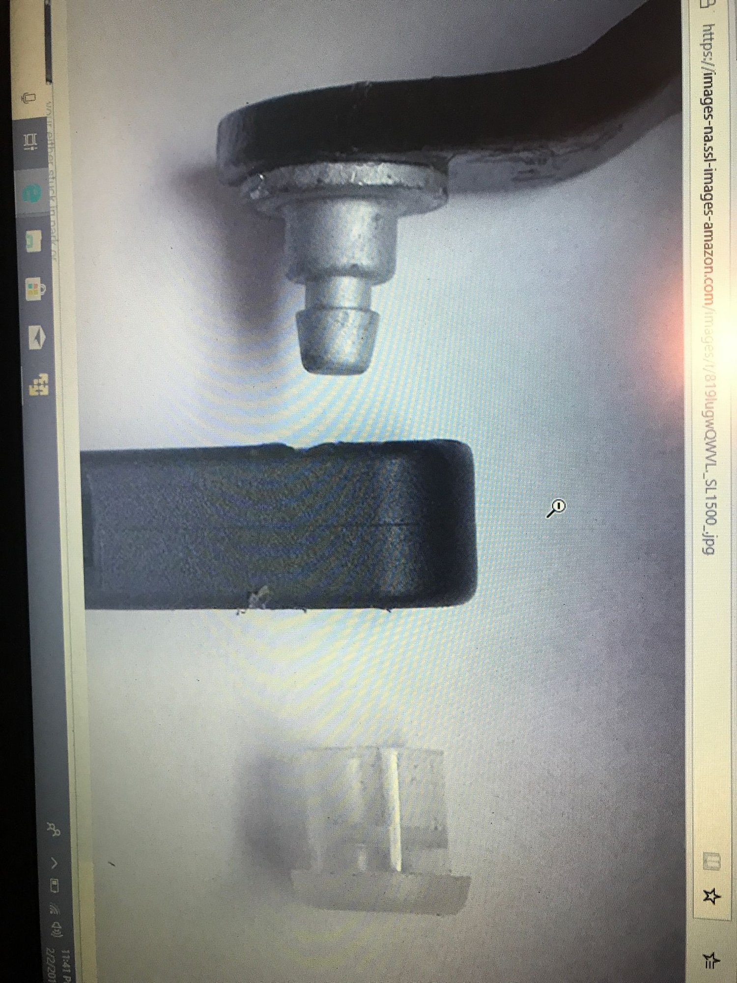

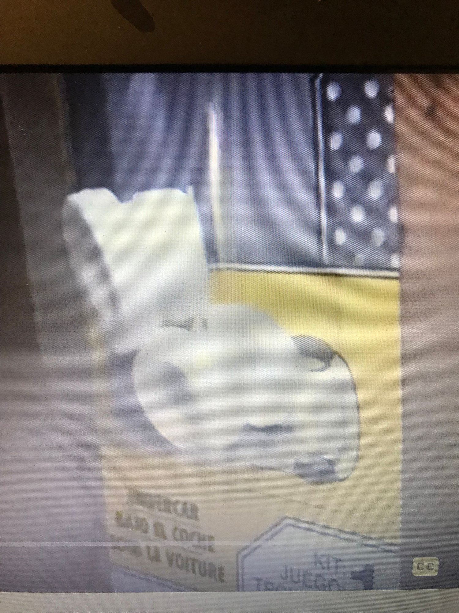

check the range selector arm on the transmission. the plastic bushing degrades and the shift cable comes off the arm. very common issue with GM's. i had this issue.doorman sells a plastic bushing the part number is 14055 GM shift linkage bushing. you might find it in your local autoparts help section

its not to bad to replace the shift cable you do have to open the center counsel to get to the other end attached to the shifter... then just follow the cable to the transmission. but in my case i also had to replace the lever on the transmission. the rod pin had also rotted to the point the new shift cable would still not lock on. the transmission range selector lever is gm part number 15082892 incase you need it.
but i did wind up sheering the nut off that holds that arm onto the transmission as it was seized on. rust penetrant or fire did not make it budge and required to open the transmission to replace the control lever cross shaft / gear shift shaft. the part was like 12 bucks but cost me 500 for a shop to replace it. its not a hard job but i did not have the part, space or the time to do it. much easier on a lift then on my back in my driveway.
