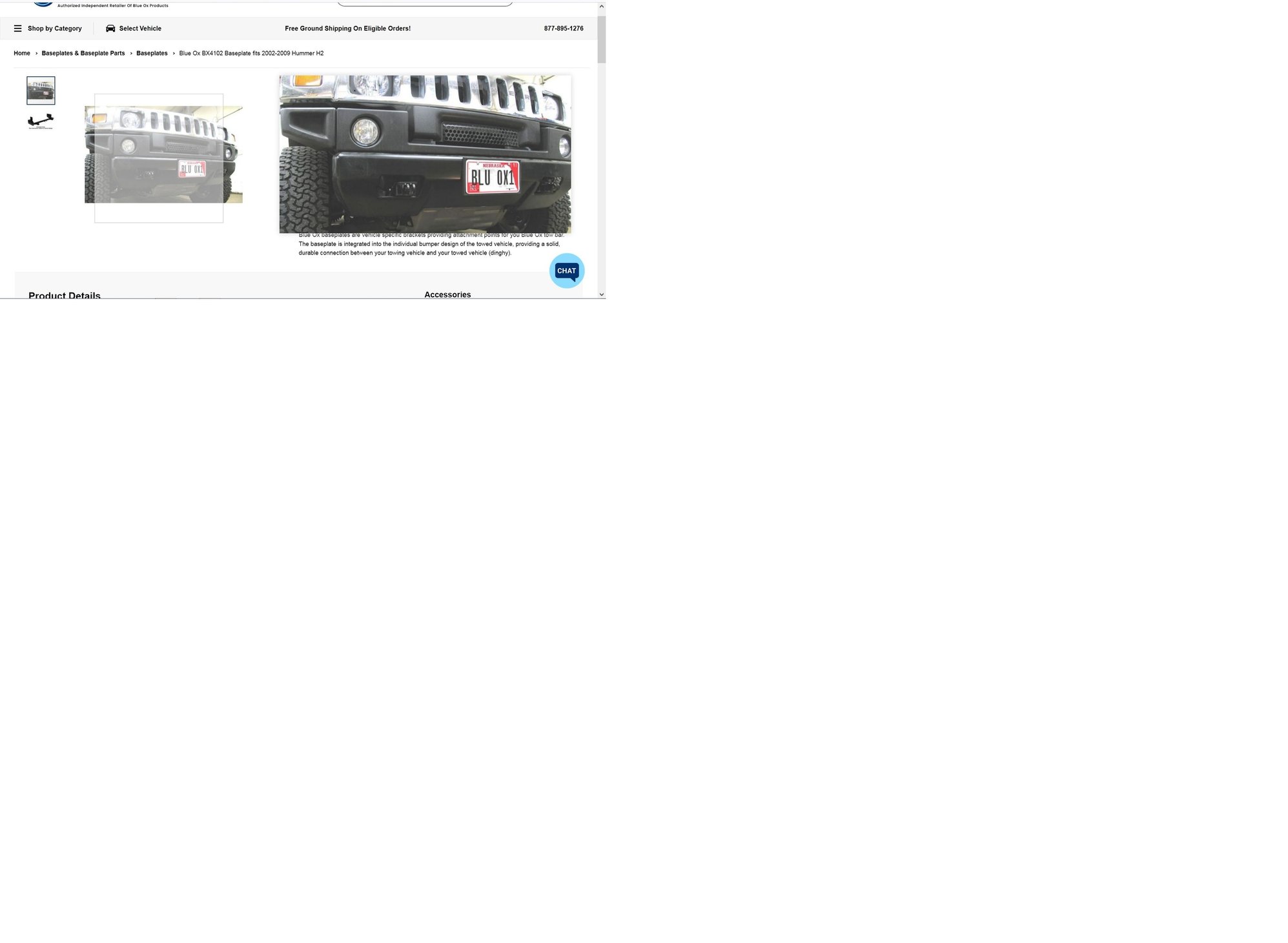

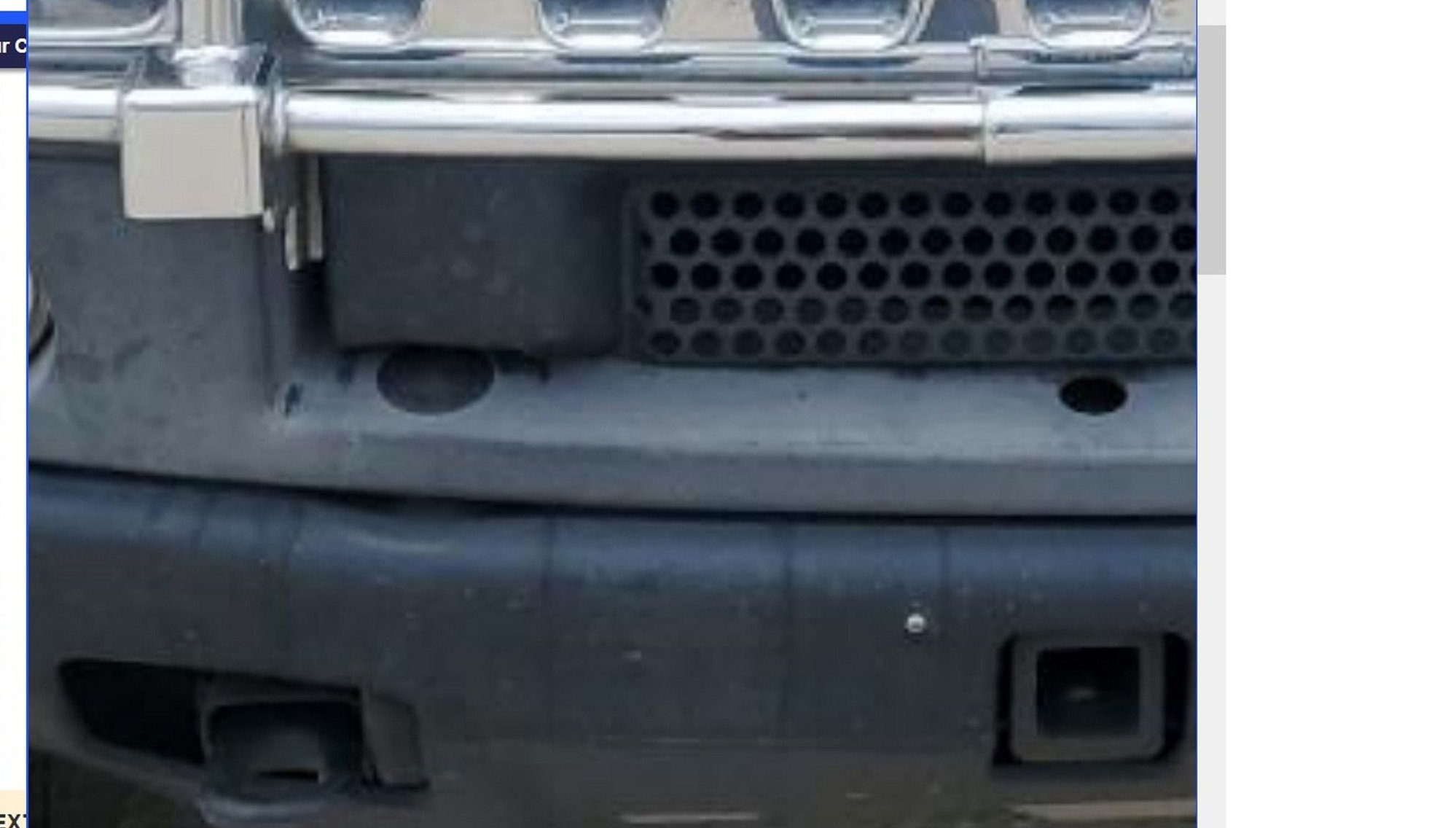

are these attachments , attached at the recovery rings mount?

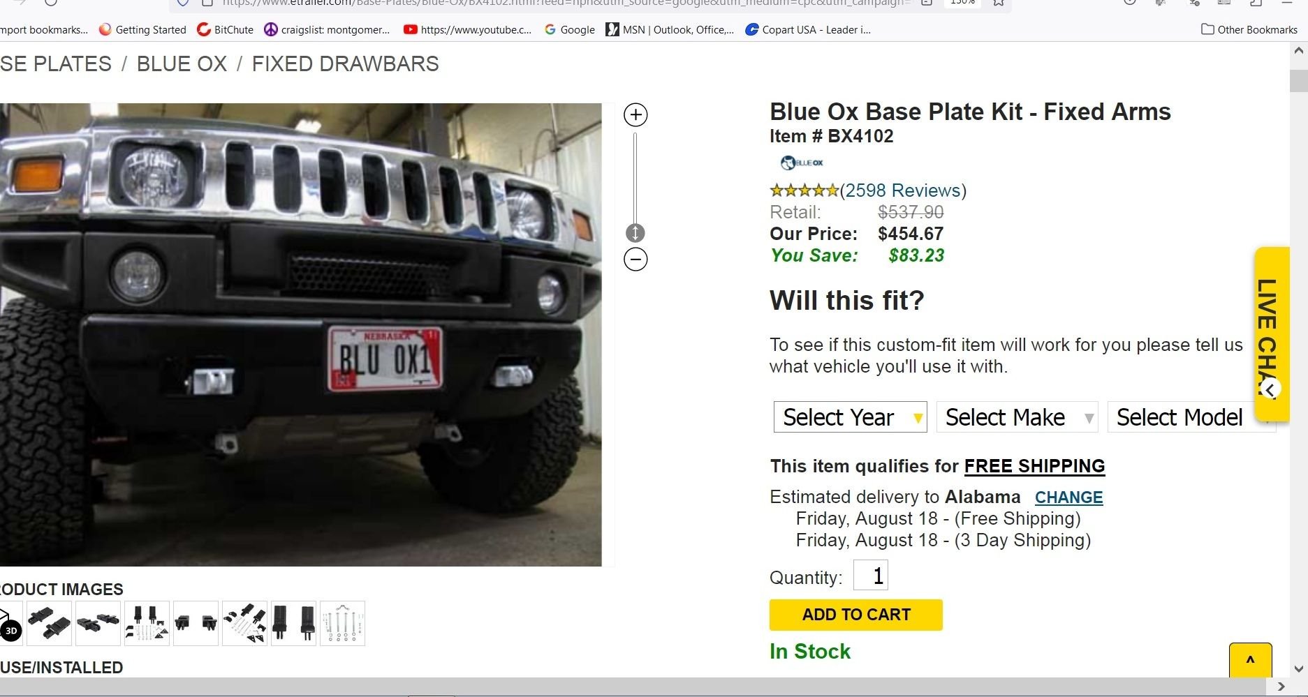

I think I can get away w/ just this in place of recovery rings
then rent the bar from u-haul?

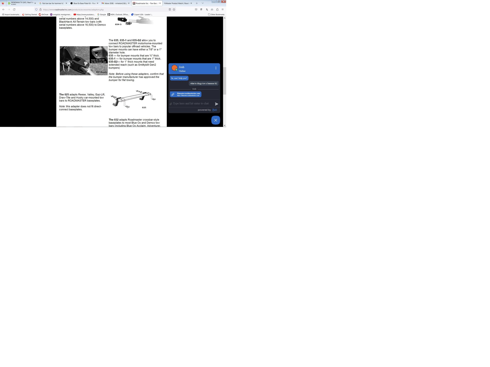

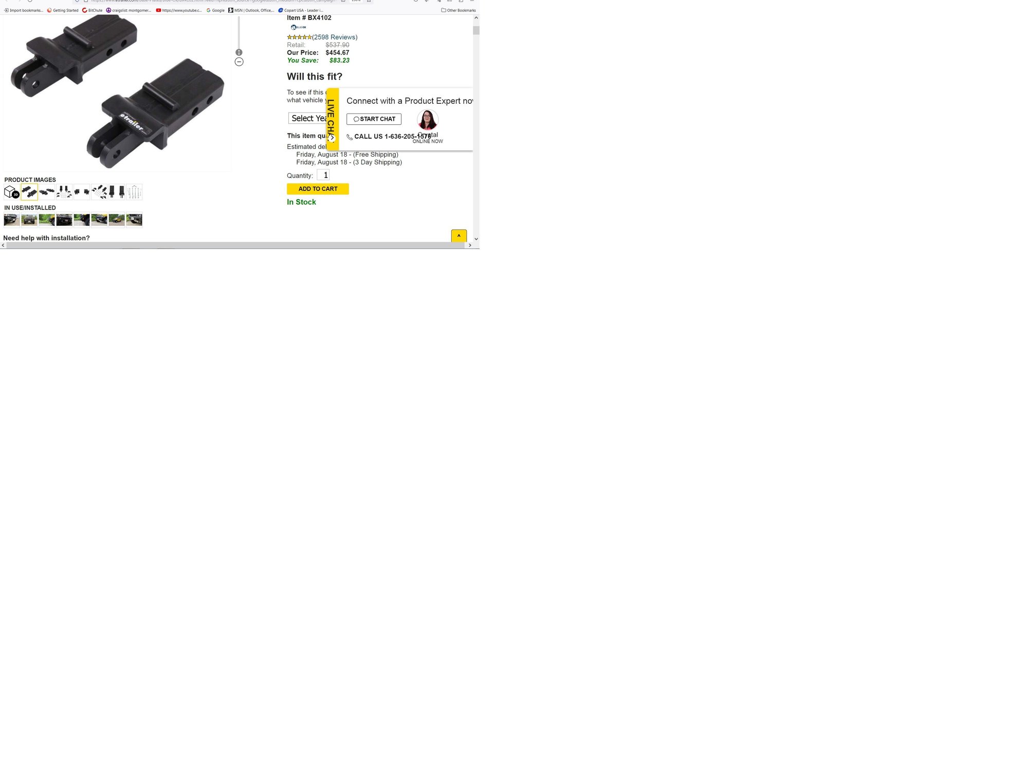

uhaul doe's sell a contraption that attaches to the front where the recovery rings are mounted I believe the pins that hold these recovery rings also hold this contraption. thanks for advice

ok I think I've figured it out the H2 requires stock recovery hooks replaced w/ a backing plate. then the contraption is attched.
correct me if I'm wrong
