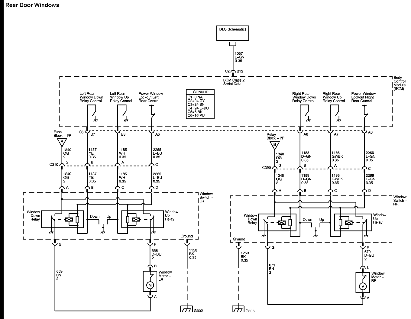

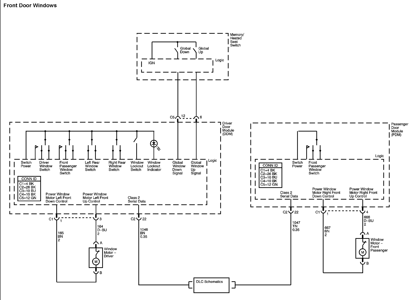

Motors are good. Switches need attention. Check/clean contacts. If you cant get them to roll up, replace the switch, in the meantime jump the connector(paper clips work).

I tried at the switch for the midgate switch and it sparked :/ Same with the sunroof switch but it didnt do anything but make a click noise.

Wrong jumper connections, check for a blown fuse? Use the wiring diagrams.
