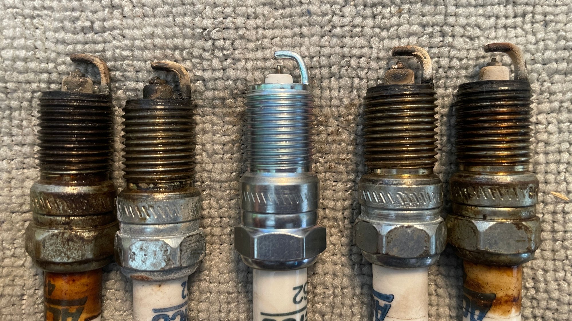

Spark plugs after 185K miles. Looking forward to starting him up in a few hours.
New one in the middle…
Those are NOT original spark plugs installed on the assembly line! Looking at the condition, your engine has issues.

Looks like a perfectly good set of used high mileage spark plugs to me.

No issues. Those used plugs look completely NORMAL. Rough, but normal. Note #2 burned electrode and gap.
Since gaps are out, you should notice smoother running with the new set. Also, gap them, do not trust the out-of-the-box gap.

Didn't have any issues prior to changing the plugs, but WOW after they were changed. Idle was a little lower quieter. Everything so much smoother. It really fires up now. Funny, all the pedal pressure has changed. Good call on measuring. Ill do that on my next H2. New exhaust comes in a few weeks. This vehicle gets getting better each month.
OP does not show the "set". Look closer at the 2 on the left:
