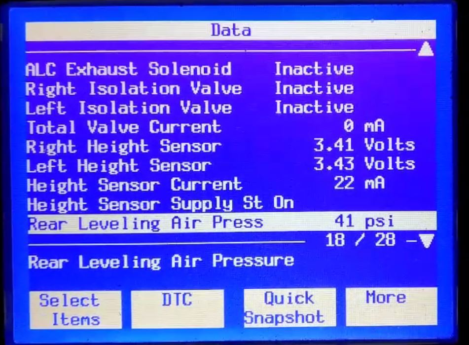

Yours should be similar, anyway for the twin compressor AS unit its not a pressure "switch" but a pressure "sensor". If you have a Tech2 you can see the actual pressure levels (see attached)
