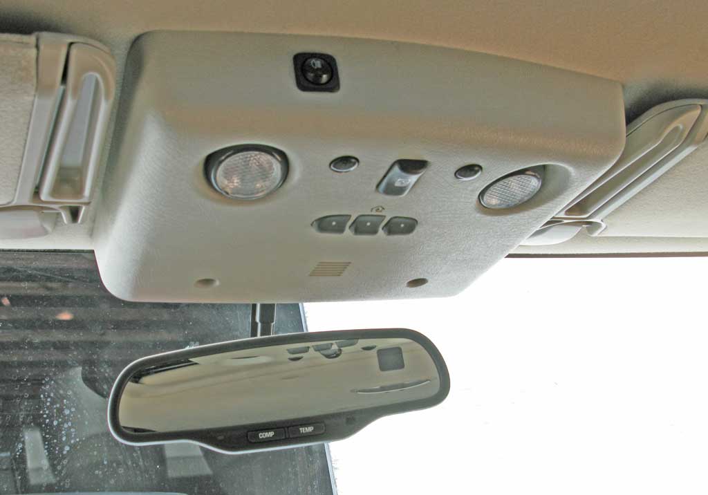

Hello everyone, I just purchased a 2003 H2. I'm trying to get the roof mounted light bar (looks factory to me) to turn on but am not able to find a switch for it, dont have an owners manual. Does anyone have any info or link to help? by the way she's a beutiful.
Old Jun 18, 2022 | 04:18 PM
Should be a switch on the front of the ceiling console. I have seen at least one where that same switch was installed under the rear wiper switch though but 99% are on the ceiling console. The black switch on the edge...
Download the owners manual from GM - https://experience.gm.com/support/ve...manuals-guides
There are certain aspects you should be aware of like proper use of the 4WD buttons. They look the same as in the GM trucks and SUV's but work slightly different since the H2 is full time 4WD.

Thank you for the photo and info. My H2 does not have the black button so it must have been added on. I will have to figure out how to wire it up. Perhaps I can locate a wiring harness and roof mounted console with button? There is also the possibility that the harness is there. Here are some pics.

The one installed under the rear wiper switch is NOT OEM.
I installed one there for a 3rd party HitchCam (now out of business) high mounted backup camera.
Looks the same, but not OEM.
All OEM Delta brand light bars had the light mounted in the overhead console, if I remember correctly.
It has been 20 years now since the 2003 H2 launched, so I could be wrong on that.
Irrespective of all above, there were NO SPECIAL edition models with light bars in the early years. So the OPs 2003 is aftermarket, NOT OEM.
Maybe the seller did not finish wiring it up. Look for a wire leading to the top left marker light from the light bar. There is a connector hanging loose on the roof there.
